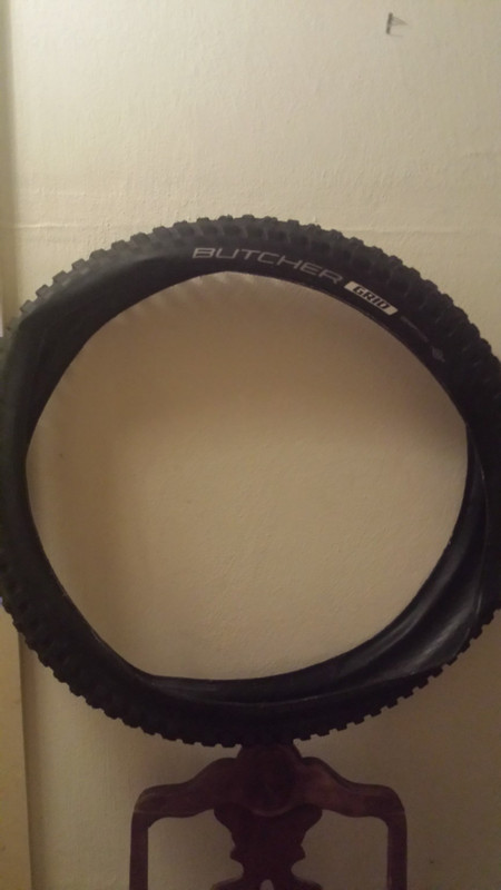

    Quote Originally Posted by hitechredneck View Post
    The new butcher grid tire is very foldy no matter what rim you run. If you take the tire off it will no lean up against the wall and stay in a cirlcel like a maxxis EXO will. It will be a big lump on the floor.
    I had to try it; here you go. Tire is resting on the tip of the chair and leaning against the wall, otherwise unsupported.
    Makes me wonder how many posts on this forum are people talking completely out of their ass.

    Quote Originally Posted by eb1888 View Post
    If the front Butcher folds over on a 30mm inner rim that'll tell you the sidewall isn't being supported enough. The response is to go with a wider rim, say 40mm. If the tire is only 2.4 I don't think it should fold over. Let the pressure down to 14 and put sideways pressure on it with your bars when stopped. And look at the sidewall at the ground. It should crinkle not fold over. A Bontrager XR2 Team 2.35 would work on that rim. at 14.
    Yes, an XR2 to replace a Butcher. Brilliant.

    Quote Originally Posted by Schulze View Post
    i have 4 of them, none of mine will stand up for more than a few seconds. Im not talking out my ass because you are able to do it 1 time in one photo. the tire folds over and causes a wash. I am not the only person to notice this. Should i post a picture of mine piled up on the ground and say I told you so? How long did it stay up like that? how long did it take to get it to stand up? do it with a maxxis next to it and leave it for a bit then get back to me about talking out my ass.
    PS notice the shape of that tire.... looks nice and stable.............

    I just grabbed it leaned it on the wall. Then put the chair and set it on there for extra effect. It was crammed in a box before. It's still up there.
    So yeah, you don't know what you're talking about.

    This thread has headed into silly world, now. The Butcher works fine on hardpack.
    14 psi (lol) or 40mm rims are unnecessary/silly for cornering a Butcher or DHF or similar tire. These are some of the best all around tires made, but do require some technique.
    A tire leaning against a wall is meaningless as regards the OPs issue.
