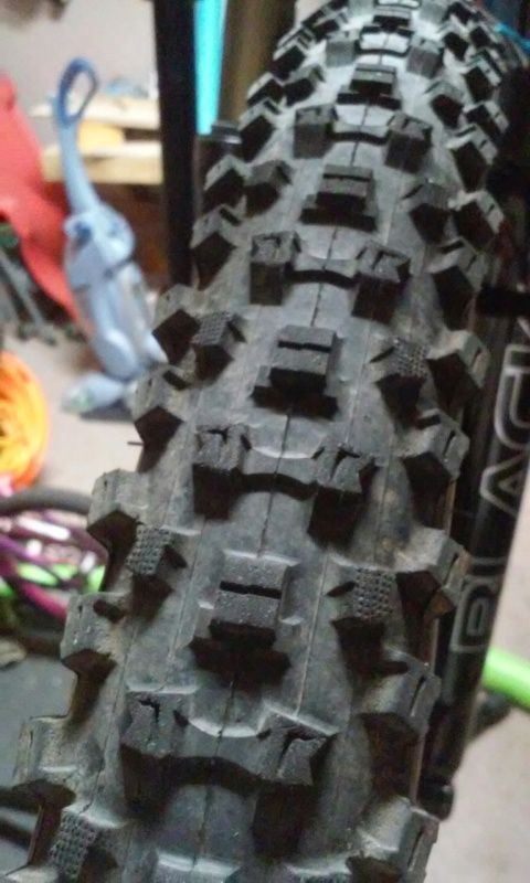

    Forte Tsali 26x2.2
    I just this week installed the Tsali 2.2 on the rear. This tire has a very tall profile and instead of a broken line of edge knobs, the Tsali has an almost un-interrupted line of edge knobs with ramped intermediate and center knobs. It's a bit like a Small Block 8, but the knobs are about twice as high and separated just a bit more. This is a dual durometer tire with a 60A/70A combination with the higher durometer in the center ramped treads (I'm guessing).

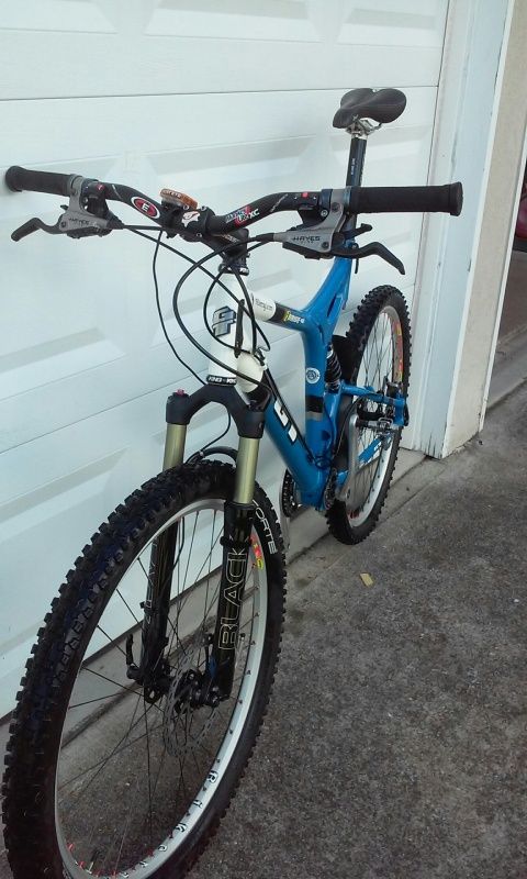

    Setup Issues
    The Pisgah fits inside the fork very nicely. The high volume casing is as tall as it is wide, so it just looks right. But, riding an old scoot has its disadvantages...My old bike frame was designed around early 2000's race tire tech when 2.1's were "big" tires. So, I had to modify the rear fender of the iDrive a bit, but I got it sorted. Here, you can see how tall the rear tire actually is. I had to shave my rear fender lower mount bolt and heat up the fender in the seatstays and mold it better to the brake bridge (or whatever they call it now). I won't go fender free on this frame, but I might have to mod this if it ever starts being an issue. For right now, it's got about 3/16" clearance all around.
    (not sure if you can see the clearance, but those with iDrives will understand)

    Bike:
    2001 GT iDrive 4.0 Large
    Mavic x317 disc/Wheelsmith DB14s/American Classic disc
    Manitou Black Super Air SPV 80mm
    '04 Shimano XT Derailleurs, LX Shifters 2x9 22t/32t, 12-34t cassette
    Truvativ Firex square tapers on BB-UN72 (XT)
    Raceface/Easton cockpit
    Hayes HFX-9 Carbon 180mm/160mm

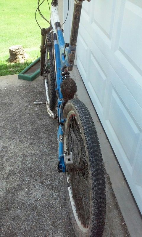

    Ride update....sloppy rocks and roots!
    4th of July ride today after a long night of rain. Typically, the trails are closed here after a night like that but they weren't today. Figured I'd go out and ride a loop or two and see how they do in the snot.
    I rode the South Loop at Blanket's Creek and it was WET. In Ga, mostly you don't get mud, but a layer of water on top of the packed clay. The South Loop has a lot of loose babyheads some off-camber climbs with rock shelves and lots of roots. I was tentative, but I must say they rode very well for the conditions. I was able to clean the outer uphill which is about 150 yards of rocky outcroppings and shelves with large cross roots with no problem. I was pretty surprised how the rear gripped in the wet.
    Overall these tires have exceeded my expectations. At 34psi today, they were fast and gripped very well on the wet rocks and roots. I actually felt a little like being back in Ct for a little while.
    Looks like I'm in for some maintenance tomorrow:

    I-Drive rocks!

    Thanks! Yes, they do/did. I've ridden every version of the iDrive and this one still works the best. It's got a built in platform.

    I didn't notice before but I think your rear tire is installed backwards, at least backwards from the Tsali on my hardtail.
    I looked on mine and realize it doesn't specify direction but I installed it the same way as my Stumpjumper with a Larsen TT tire (which I thought the Tsali was based on) and that one is directional. Just an fyi.

    Yes. I'm running it in reverse orientation so that the biting edges are there for better climbing. Habit, I guess.
