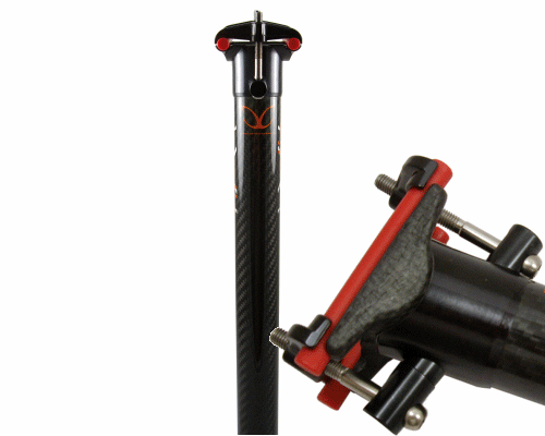

    I'm thinking about ordering one of the eXotic carbon posts off ebay. They're reasonably priced, light for the diameter/length i need (173g for 31.6 x 300mm) and the lower cradle is a full rail support like the syncros/thomson ones.

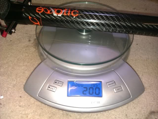

    I got one of those seatpost ! 31.6mm @ 350mm.
    Came a little bit under claimed weight. Identical to a 3T Doric seatpost.
    Ugly, but works great !

    I would have gone with that eXotic post but unfortunately they don't make them in 30.9 diameter. My daughter uses the eXotic stem and handlebars on her bike and for the price nothing comes close.
    I wonder if the cradles can be bought separately?
