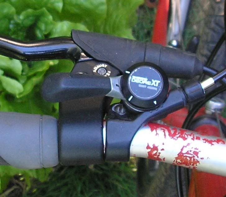

    I have a technical question: I want to drill out the stripped threads in my plastic (ca. 1989) Deore XT thumbshifters (see photo) and use a longer bolt and a nut to secure the shifter to the handlebar. There seems to be enough material there to make this work. Has anyone tried this? Might you have suggestions?

    Problem is that a bigger diameter bolt usually has a bigger head that won't fit into the recessed space for the bolt head.
    What I have done in the past, is alcohol the threads clean, then fill them somewhat with metalized epoxy, then re-drilled and tapped ""the original"" thread size. Then you can use the original bolt.
    Get the kind that says you can drill and tap it on the instructions, some aren't tough enough. Even so, you'll have to exercise care when tightening that bolt in the future.

    is a bunch of things you can do besides drill the whole way ..
    for example You can always try to drill a little farder into the casting, being careful not to damage the already wasted threads, then tap the bore with the 6mm bit and use a longer bolt,
    A 1 to 1 ratio of the diameter/deep is accepted (1.5 of the diameter is optimal for load bearing structures), so 6mm bolt with 6mm of useful threads will be sufficient, even less if is just to clamp down.
    Using a 1/4 fine thread bolt with a Phillips head (so you don't need to carry a SAE allen around) is also really simple ..
    Or If you want to go even more sophisticated you can use a "Time sert" or a helicoil or a specific epoxi resin to rebuild the damage hole, a company call "Delcon" is the Cats Piyammas on this segment.
    in short don't lose your sleep over is no big deal at all.

    In a pinch I had to drill through my xt shifter. I had to break out the dremel tool to shave some material too accomodate the new nut and bolt. A dozen years later its still works and holds on to my handlebars.

    I've done the same thing as chefmiguel and I used whatever nut and bolt fit in the hole at the time and it worked fine and that also happened back in like 1996 on a Wicked Fat Chance...I think that shifter is currently on my Ti Fat Chance with the crappy bolt/nut combo and still works to this day...Just don't tighten it too much as it'll eventually crack since it's not really meant to drill out from the top.

    Heil-Coil.

    Yup, or Time-sert.
    Actually if you haven't completely mangled the hole with a drill yet, you can actually use a bolt that is about a milimeter longer than stock. The stock bolt is kind of short, combined with the weak threads in the base material, so you wind up only catching a few threads to begin with. The slightly longer bolt will grab the remaining threads. And from now on always tighten these shifters just to the point where they don't move easily on the bar.

    Do not do that. It will not work. Besides, the mount is aluminum. You are better off drilling and tapping for a larger bolt, or to add a coil tap so you can use the original bolt size. There is no room for a nut if you drill all the way through. It will interfere with the shifter. You might want to try a little longer bolt since there are extra threads in the mount.

    before you drill try the same type bolt but a little longer one. often the threaded part goes deeper than the lenght of the original bolt and then a few threads might be left that are undamaged. has worked a few times for me.
    that's not plastic btw, it's aluminum...

    I like the longer bolt idea as a first simple attempt at solving this. I'll try to rustle up something that fits the bill. I'm familiar with helicoils and such, but that seems a bit overkill since this is not a high stress part, and it is plastic after all. Elegant certainly, but I don't really see myself tracking down such a tiny helicoil (or is there an obvious place one would look for such a part).

    sometimes its just the obvious things in life I just tried the longer bolt suggestion & it worked for me, thanks guys
    119
    I'd go with Carsten's simple solution on this one - every set of Xt thumbies that I've ever threaded I've just taken the bolt out and replaced with one thats a few mm longer. I'm using a set of those on my Bradbury Manitou right now with no worries. Don't know why but they used really short bolts on those shifters but threaded much deeper and as long as you were using original shimano bolts when you threaded them you'll still have loads of good threads in there.

    Well I tried the longer bolt, but it didn't take. Then I rummaged around in my bolt bins for something that might work. After some fiddling and a bit of drilling I got it. Not the most elegant solution, I admit, but very effective, and no trouble with clearance for the shifter movement.

    That's pretty much what mine looks like except I was lucky enough to find a flat-head screw the was recessed into the hole up top, making it less noticeable. Good Job!
