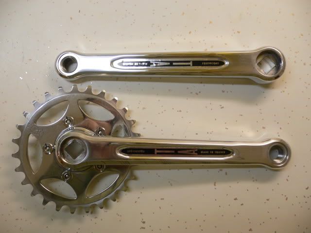

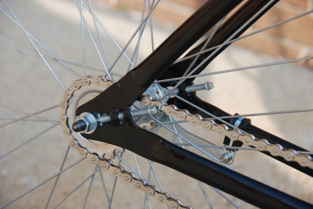

    If you use a square taper crank, you can use what is called a "euro conversion" bottom bracket. Any BMX or Schwinn shop can set you up. They range in price from < $10 to pricey if you go the Cook Bros. route, for example. I paid about $8 for my steel Tioga set up.
    I'm using a 180 mm TA crank with square tapers, because that's what they used back in the day. It can prove a fairly spendy way to go, though, depending on how clean the cranks are, but they come up on ebay regularly. They are a bit flexy and were known to break eventaully under hard use. You can find both 1/2 and 1" (skip tooth) pitch chainrings for these and other track cranks. Otherwise, look for a nice vintage mtb crank like a M730 or Deore Shimano in 175 or 180 if you choose the 1/2" pitch route. If I were to do it again, or if my TAs ever break, that's what I would/will do,
    If you choose the 1/2" pitch (what a standard chain is), it can be tough to find a 1/2" pitch rear cog for the Morrow. I lucked out and found a 1/2" cog still attached to its driver, the typical way you'll find them, so I simply swapped my 1" for the 1/2". Search ebay.
    I needed a 3/16" chain for the 1/2" Morrow rear cog, though; a 1/8" chain was too narrow. The 3/16" really a small motorcycle chain. I got mine from KMC. They're cheap, and heavy.

    That's the one I used with a 68x115 Bottom Bracket... but I'm planning on a 68x118 for Klunker #2 because the crankarms come scary close to the chainstays.
    The TA's are spendy, but it's hard to beat the look. Aemmer's Campy cranks look great too.
    One other nice thing about the TA's is that you have a lot of options for chainring sizes. I'm running a single 36T on Klunker #1 and am planning either 30T or 27T on the Klunker #2.
    I'm not sure when/if they'll become available as a stand-alone part, but Electra is making a TA Cyclotourist copy for their Ticino line of bikes... check out their website.

    The frame is being coated this week. Bottom bracket adaptor is on order. Wheels are being built. Truss rods are trimmed to fit. I found a nice set of cranks today that should work nicely.
    http://www.nbbikes.com/
    ^^^Best Bike Shop of MTBR 2008^^^
    Certified Bike Junkie
    Reputation: muddybuddy's Avatar
    1,747
    Are those the new TA copies?
    Need: McMahon brake for roller cam mounts, Mountain Goat fork.
    Master of the Face Plant
    2,901
    Quote Originally Posted by muddybuddy
    Yes, They are made by Electra. I got em cheap at the bike show. No sales tax or shipping so I figured I would try them.

    Made some progress today but I am moving soon so this is on hold for a while. Luckily I am moving within riding distance to work. I will be able to ride on the street to work and after take an off road route through the canyon. I will be getting about 8 miles of dirt daily. I think this bike will fit the bill nicely as a rugged commuter.
    I used the Truvativ bottom bracket adaptor and it works well. The UN-73 113 mm bb is a perfect fit but I may need to use a spacer to get the chainline right. Got a piece of 13/16 6061aluminum rod stock for the post. It fits but it will only go in a few inches so I need to smooth out the inside of the seat tube or grind the post a little. Here are a few shots.

    A little more progress. The wheels came out nice. I knew the fit on the rear was going to be close with the roller brakes but it fits, barely. Plenty of tire clearance for the big Nevegals. Wasn't sure on the post length but the rod was cheap so I bought enough for 2 posts, polished it out and it looks great. Found a new Brooks at the swap meet for 50 bucks too. I lost the damn chain adjuster bolts so I will have to buy some new ones. Oh well they were a little rusty anyway.

    Those cranks are sweet, any idea if they are available online somewhere?

    frog
    The cranks are Electra TA copies and they should be available soon. I got mine at a bike show. With no ride time yet I can't comment on the brakes although the engagement and lever feel is very solid. If all goes well on the maiden voyage today after work I will do my morning commute on it tomorrow and hit 7 miles of fire road on the way home. If I don't reply to this thread after tomorrow send out search and rescue.

    I am using the same idea to mount a chainguard on my Silver King. I used a 31.6mm generic clamp for the same purpose when I changed to this fork.

    I guess that would explain why the 13/16 rod I used had to be milled down a bit to fit properly. I found another Mercury frame for sale locally and I am so tempted to buy it but this bike was so expensive to build I must resist.
