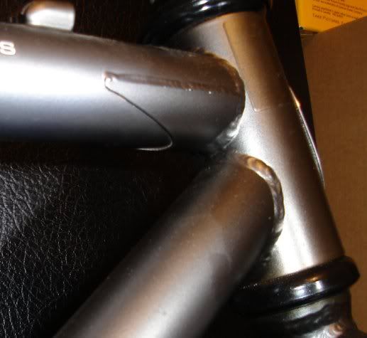

    The 970 and 990 always had nicer tubes. The TIG welded versions were easy to spot even without decals due to the gusset at the top/head tube junction.
    I so badly want a 970/990 in the matte silver ^^^^^^^^^^^^^^^!
