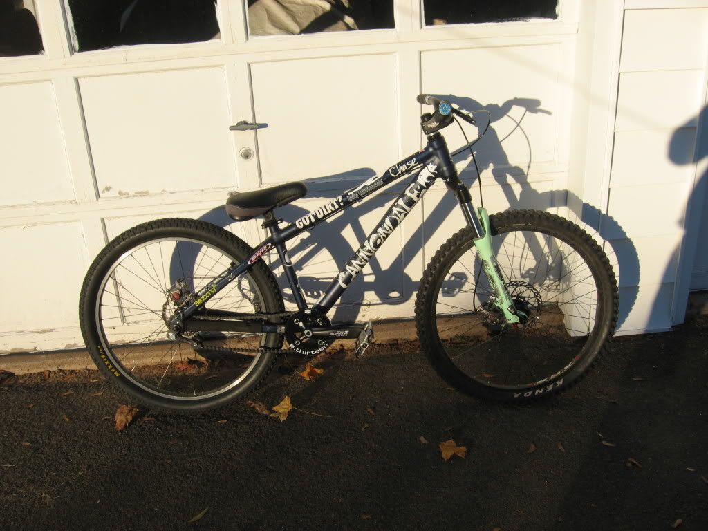

    I have a 05 cannondale chase that I'm looking to get rid of, its got some upgrades and has a 24" TT which not many companies offer. PM me if you interested, I'll let her go for a good price.
