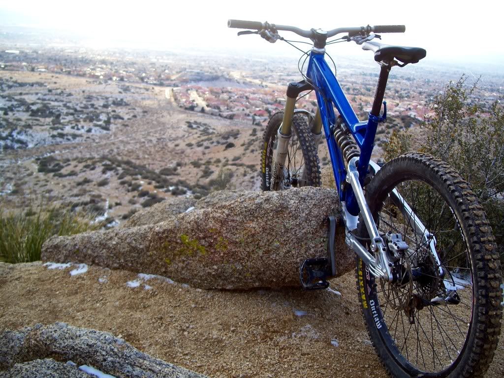

    i love my totem coil. at 230lbs ish i'm no feather but the coil is still the standard medium and it feels plush and i haven't bottomed it too much. perhaps i'm not trying hard enough! the only mod i've done is change the little o-rings in the damper cartridge as they blew really quickly from standard. it only takes ten minutes and i've done it on my totems and a couple of friends lyrics too.
    not sure if dt knew about the totem when he designed the highline but it sure feels like they were made for each other.
    loving the blue highline.
    Like a match made in heaven. Check out the MX tune if it makes back to shelves. Darren works a lot with RS and his new damper appears to mate very well with the Totem (coil).
