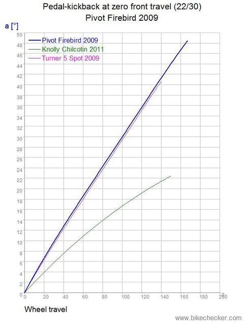

    Here is a little comparison in Linkage looking at chain extension and pedal feedback in the granny gear for the Pivot Firebird, Turner 5 Spot, and the prototype Knolly Chilcotin.
    Now, I know that _dw says that every time someone runs a Linkage model calculation a baby seal gets clubbed, but here is what I find curious and interesting in this particular analysis. If you compare the Spot and the Firebird, two completely independent models for different bikes designed by different manufacturers (presumably with totally uncorrelated errors in the translation of the linkage geometry to the model) almost match the chain extension perfectly throughout the travel range. This seems to hint at a design characteristic that _dw aims for in his suspension platform.
    As a comparison, I plotted also the prototype Knolly Chilcotin chain extension (4x4 suspension) to show an example of a more neutral design. Of course, the more neutral platform will squat more under acceleration and hard pedaling, so pick your poison and find which trade-off works best for you and the terrain where you ride.

    Reputation: nybike1971's Avatar
    1,884
    Quote Originally Posted by AndyN View Post
    Are you suggesting the chain angle off horizon has nothing to do with anti-squat?
    Not saying you're wrong, but, numbers please.
    I have crunched the Linkage analysis for 22/30, 22/36, and 26/36 (very close gear ratio to 22/30) on the Firebird and the pedal feedback charts at zero front travel are shown below.
    You can read about the pedal feedback calculation here, but in essence there are several factors contributing to pedal feedback as the suspension cycles and the total amount depends in principle on both the front and rear gears. While it is true as you say that the bigger rear cog to preserve gear ratio will negate some of the benefit of the bigger chainring, the effect of the bigger chainring dominates and the two don't balance each other out exactly.
    Basically, the angle of the chain affects the overall pedal feedback to a lesser degree than the backward rotation of the cranks to account for the chain length change between cogwheels' upper contact points. While the chain extension (measured in mm) is essentially independent of the gearing, the feeling of the extension at the cranks is given by the ratio of the extension itself to the radius of the front chainring (bigger front chainring, less feedback).
