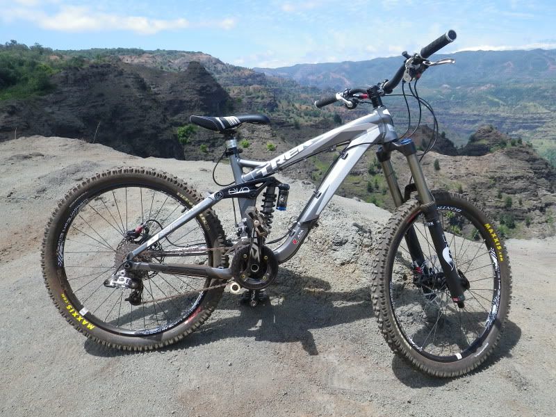

    Cracked Swingarm/Chainstay on a Trek Scratch
    Crack on chainstay.
    Decided to replace all the bearing on my rear suspension.
    Bearing part numbers:
    Front EVO link: TPT6901VRS
    Rear EVO link: JNK6900VRS
    Front chainstay: JNK6903VRS/10
    Rear chainstay: JNK6903VRS
    Called my LBS and I had a replacement chainstay in about 1 week. It was covered by warranty. Note: The new chainstay comes with new bearings installed.
    Trek's warranty: https://www.trekbikes.com/us/en/supp...ited_warranty/
    Used a vise as a makeshift bearing press. The spacer in the rear is a cut end of a handlebar. It worked well as a backing so the bearing could be pressed out.
    A hammer, socket, and extention can be used to install/remove bearings that cannot fit in a vise well.

    Ok it has to be asked (maybe because I've got the same frame!), how did it happen?

    This is how I ride it so maybe one too many of these drops, haha.

    Nice! Kauai style eh?
    Good to know Trek hooked you up with a new chain stay too.
    Reputation: rat7761's Avatar
    342
    Yup. Like the Scratch so much I bought a spare. =)
