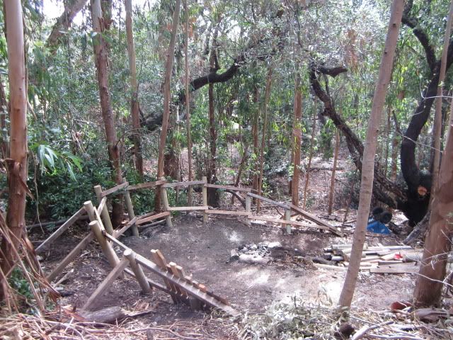

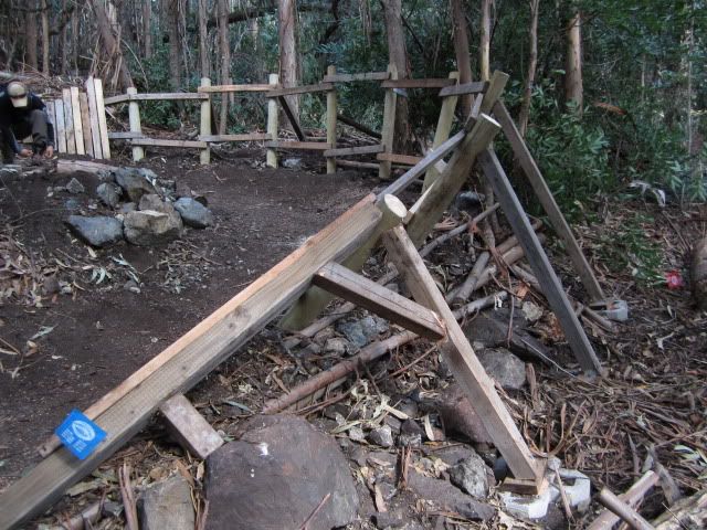

    We just finished building this on Sunday. We didn't have room to expand the corner radius, and the existing corner was really killing the flow. We would have had to build a massive dirt berm or use pavers to pull off a fun corner otherwise, and the soil in our build area is difficult, either loose & full of duff or rocky, not to mention the drainage problems on a steep sideslope. We still have to build up the base a bit, but it's basically done. I really prefer riding dirt too, but given what we have to work with I think this is a pretty sweet compromise.

    I think that last wooden berm is a far better option than dirt in that spot and it is built well (I think), but the guy riding it is in trouble. I'm sure it's not completed in the pics, but there is almost no tranny between the boards and the dirt, so commit or die. It's really tight and steep(-sided) and it looks difficult. I'm old enough to doubt being able to bend my neck far enough to see through it to the exit - at least not without an on-site chiropractor. Maybe a 24 incher would hammer it? Pics can be deceiving, I may be wrong and this is not meant to be criticism of that berm so much as an observation of bermology.
    What I am getting at is, if it isn't perfect, then how do you make it better?
    With dirt you get the tools out and add, re-shape, contour, alter drainage etc as needed. I can do that, but I wouldn't have the guts to build with wood for fear of not getting it right straight-up. How do you test ride as you build? We have a couple of crash test dummies, but they do have some remaining brain

    That's a spot on observation from those pics, because it's not done yet
    The rider is Ian, and it's mostly his design & construction. He's also a really, really good rider. That was one of a handful of test runs before we weatherproofed the wood and blocked it off for the week so no one would ride it yet. The transition is being built this weekend, and chicken wire is going on for traction. The finished product (we hope) will be rideable by a wide range of riders, with a passable dirt berm transition to the wall. I'll try to snap some pics of the proper finished product.
    The ride-testing part is the bugger about wood, because we basically just have to hit it & hope it works as intended, so a point to dirt for that. In our case there's significantly more planning involved with a wood structure vs. dirt though, and we over-build, almost to a fault.
    Thanks for the complements!

    It's pretty obvious he's a good rider and those sort of runs have to happen so you know how it feels for the average rider when they don't get the rhythm.
    When you build up the dirt tranny below the wood, do you put lots of rock around the base of the board platform? Here, even with treated timber the bugs would eat and spit it out in a couple of years if the wood was buried.
    With our building, we have noticed that visual clues can make a huge difference to the line and confidence of line riders choose. When we have a tight section, apart from clearing vegetation to allow vision, we put trail clues down. Like moss covered rocks embedded that act like a runway. You can also sometimes fool the eye with such clues to take the line into "the line" you know works best entering or leaving a berm. We sometimes use drainage to do that between exit and entry to the next corner. In your corners the clues could be painted on the wood as well as in the soil.
    I'm sure that corner will work really well
    This is early work in progress, after five years of getting approvals / permits. etc. Here are photos that will give you an idea of the area. Rock and dirt are limited, what there is is loaded with eucalyptus duff.

    The peeler core in the ground is pressure treated and surrounded by rock, and the 2x4's of the decking are all weatherproofed twice, and we placed rock around their bases as best we could before throwing dirt on. That's the wood we had to work with, pressure treated would be preferred. We fully expect to have to re-deck this in a few years, so we'll see.
    We're working on the visual cues bit- we joked about painting a big arrow on the wall The sight lines on this trail are pretty open so it hasn't been a problem that I know of, but for our upcoming trails we'll need to think about it more.
