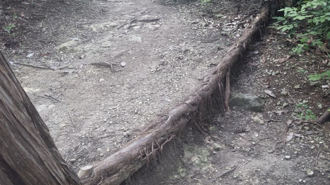

    Yesterday I rode the trails in Cameron Park in Waco, TX. The Highlander trail was a lot of fun - it's a narrow bench cut on a steep slope with grades up to 40% (I measured!) and the soil moisture was perfect for grip.
    The builders used Ash Juniper logs a lot to shore up the trail. The terrain doesn't have much available rock so I can see why they did this. Example:
    Ash Juniper is a soft wood that is used a lot in fence posts. If you strip it of bark and sink it upright in the ground, it will last 50 years holding up barb wire.
    I'm curious what the experts think the longevity on something like the above would give. With direct contact to the soil moisture I can't imagine it would be very long.

    It won't hold up. But not for the reason you suspect. You can see what's going to cause the demise of this patch - undercutting. Water flows over the top of the log, falls over, and undercuts the back/bottom. Unless a more permanent solution is devised, this will continue and it'll just erode out.
    This. It's a guaranteed failure at some point in the future. I'd never recommend using wood, since it has a limited life, but if there aren't any other options if you wanted to make a retaining wall/step, you'd bury the first course and stack on top of that. Since everyone is forced to step in the same place in front of it (especially horses), bikes will land in the same place, and water will waterfall off, the downslope will quickly erode deeper.

    I have a slope app on the cell phone. For these short, punchy climbs, the steep stuff is really good, especially if you enjoy climbing. Yeah, I'm special....
    I should have taken some better pictures, but much of this trail is on a steep sideslope, and when you start on it you're thinking, Man, no way I'm going up that! and the you just motor up it. And there's an effect of being "right on the edge" the whole time.
    The log in the picture is on a switchback, but most of the log use is shoring up bench cut on the sideslope. If it lasts ten years I'd be satisfied.

    Is that log cribbing on the outside of the switchback? Based on the age of similar stuff around here I would say 10+ years, but probably depends a lot on how wet the area gets.
    I haven't seen any problems with undercutting of stuff locally. I expect for that to be an issue you would have to have a lot of water running down the trail?

    If 10 years is durable enough for you, have at it. I try to design/build trails that won't need anything but superficial maintenance for 50-100 years. I'd rather be riding than maintaining.

    I would too, but if I'm the only dude building a 7-8 mile trail, then I'd rather get it done in 2 years using methods that will last ten years instead of getting it done in 5 years using methods that will last 50 years. The I can spend a day a week upgrading the logs to rock work while riding it 3 days a week.
    cerebroside, the cribbing is in the middle. The trail path goes to the left around that tree.
