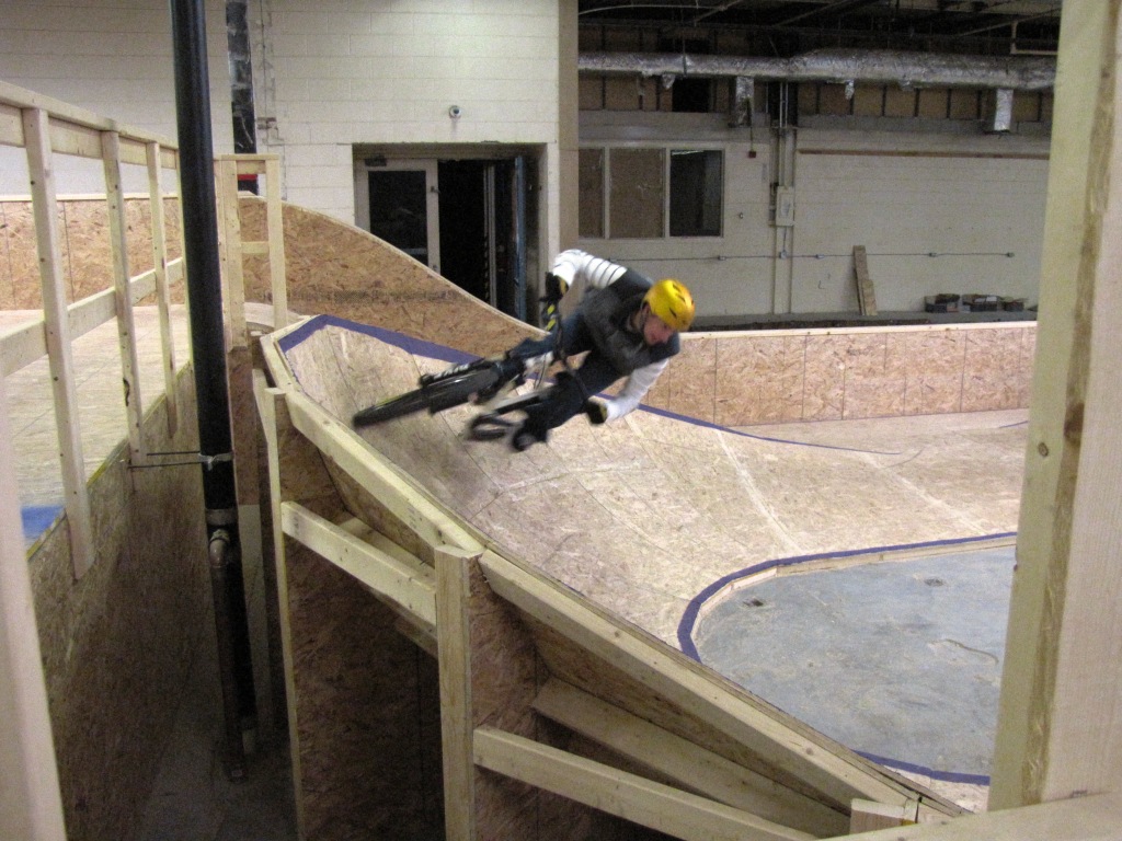

    I personally would build a half-pipe with lumber instead.

    when i say i would recommend a half-pipe instead, i'm serious. if you have any bmx skills at all--or even if you don't and want to learn some.... that amount of space would be ideal for a small-to-medium sized half.
    a bowl corner, skatepark/pool style is one version of an ideal 180 berm:
    Ramp Plans Dot Org: Mark Center's OHP Ramp.
    you can pump around these corners like berms:
    Concrete Disciples Skateboarding - Skatepark Directory & Listings for: Pennskate - Allentown, Pennsylvania, United States
