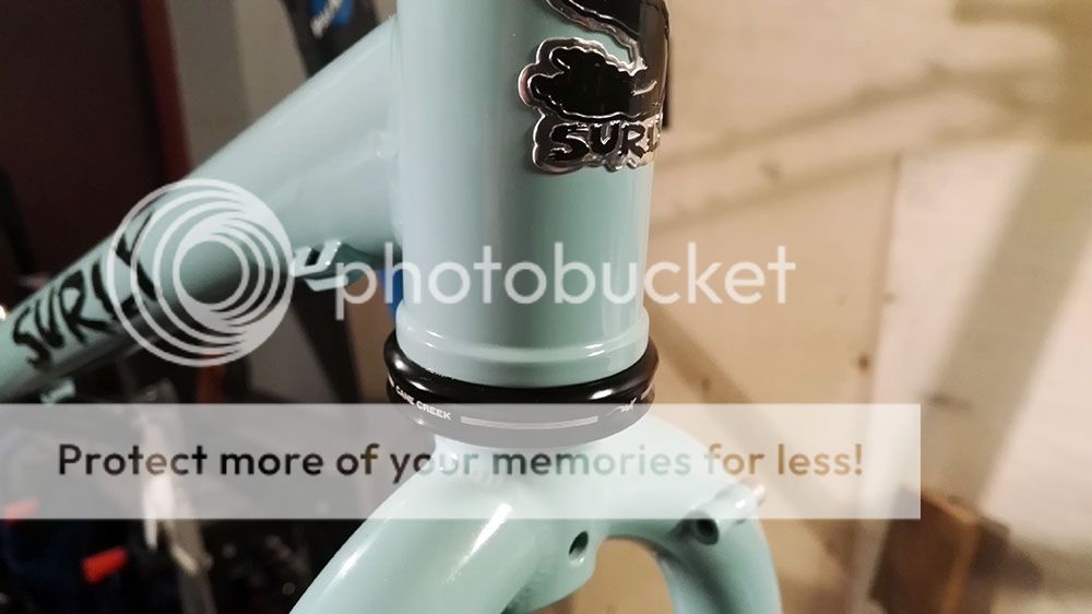

    This is where I'm at at the moment. Headset, fork, bottom bracket and cranks installed. This is a L size frame. I am 186cm tall. The stem is just for keeping the fork in place. I will use a slightly longer stem for the final build.

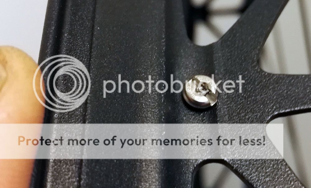

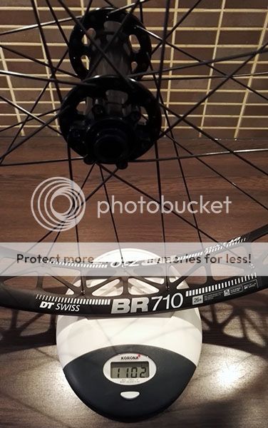

    I built my wheelset up using FatLab hubs and DT Swiss BR710 rims and DT Swiss spokes and nipples. Weight of the total wheelset is 2400g which is probably ok for an all aluminum wheelset. The front wheel is 1100g and rear wheel is 1300g. I used the DT Swiss spoke length calculator to determine spoke lengths. The calculator suggested 263mm spokes to be used for the rear and 264 for the front. The online shop I bought my parts from only had spokes in 262 and 264mm so the rear wheel spokes are 1mm shorter than recommended. As you can tell from the pics, the front wheel spoke length is spot on and the rear wheel spokes could have been 1mm taller. My conclusion: the DT Swiss spoke length calculator is super exact when using DT Swiss components and exact hub dimensions!
    Front wheel spoke length perfect at 264mm.
    Rear wheel spokes are 262mm because that's what was available at the shop. The DT Swiss calculator recommends 263, which would have been perfect.
    I spent some time learning to understand hub widths and searching for decent quality hubs. I learned the Wednesday has a 170mm rear end. Many fat bikes today have a wider hub spacing at 190mm. For the Wednesday you need a 12x170 through axle hub for the rear wheel. The frame should be compatible with 177mm wide quick release hubs as well but this may require an adapter set. The front fork takes a 15x150mm through axle hub. Ideally I would have liked to use DT Swiss hubs. A 15x150mm front hub is widely available from DT Swiss but at least at the time of purchase a 12x170mm rear hub was hard to come by. According to the DT Swiss web site, they make one, but I could not find it for sale in the online bike ships in Europe. So I ended up with the Fat Lab hubs. Time will tell how they are.

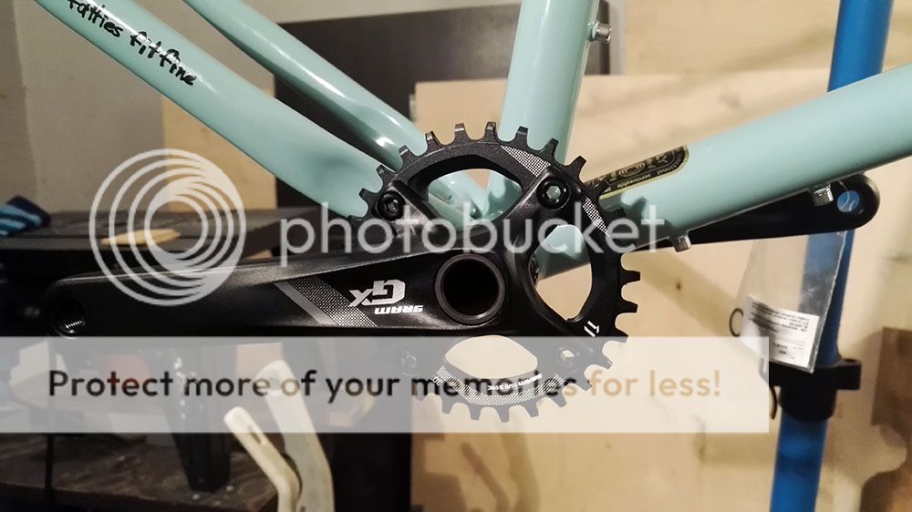

    My drivetrain will be a mix of Sram and Shimano parts. I hope this is not a bad idea. The bottom bracket is a Truvativ GXP XR set and the cranks are 1x Sram GX1000.
    In the rear I will try to run a Shimano 11 speed cassette with a Shimano XT M8000 derailleur. I am a little nervous about chain and tire clearance. These parts should arrive on Monday so I will know more soon. If it turns out there is no room for a 11s drivetrain, I will have to switch parts with my son and install his 10s SLX drivetrain. Worrying about tire and chain clearance is something I would rather not do. It seems that the fat bike bicycle is still a work in progress and standards and parts are still worked out.
    So all the parts I have got so far are installed. More parts should be incoming at the beginning of next week so if I am lucky I may have a finished fat bike by the end of next week!

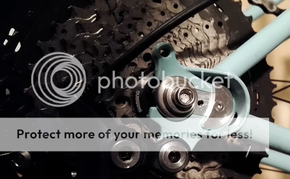

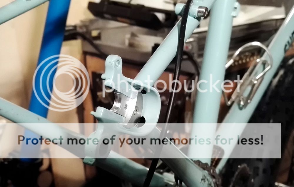

    I installed some peace of mind the other day:
    A DIY set of dropout inserts that prevent the axle from moving forward. This particular insert places the axle 18mm towards the rear. Inserts are also available in 10mm and 14mm lengths.
    I like to run the rear wheel all the way rear in the dropouts. It helps me keep the front end down on steep climbs. I can run a very short stem which helps to create a relaxed and upright sitting position, nice for technical terrain.
