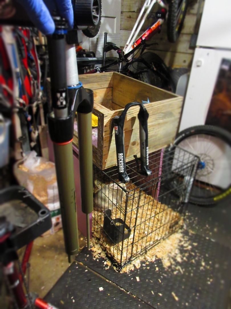

    Charger dropping in!
    Will get a ride in today and see how it feels!

    Feels just like the one in the Pike on my other bike. No issues.
    I'd say it's a worthwhile upgrade to an older Lyrik, especially if the chassis is still in good shape. You get new fork feel, for way less money. Do the topcap/tokens too - just gives you more tuning options, and is a cheap and easy bit to do.
