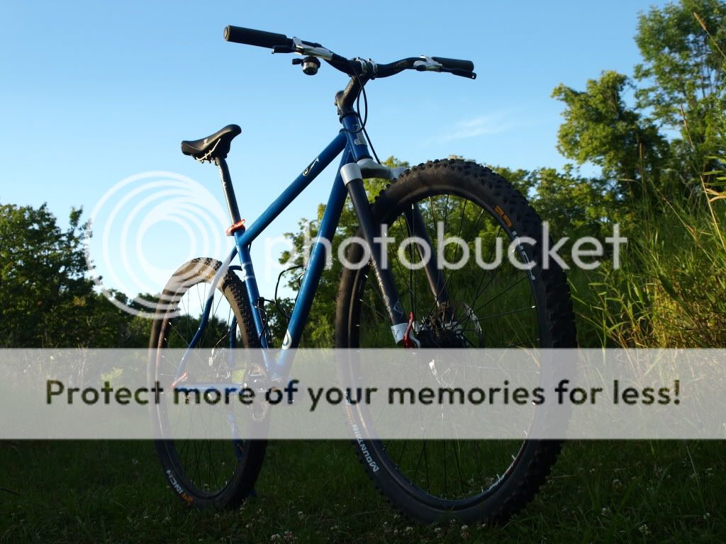

    This was my dilemma about a year ago with the exact same bike, and I ended up getting a sweet deal on a carbon rigid fork and haven't looked back. The fork I got has an axle-to-crown measurement of about 460mm (29er suspension-corrected), whereas the stock XXIX fork in 2008 (which is somewhat suspension corrected compared to the 2007 model) has a A-to-C of 440mm (2007 models are about 420mm). You are also correct in assuming that the XXIX+G is similar geometry, as I have spoken with our shop's Raleigh reps many times and found that they basically just throw a Reba on an XXIX frame. As for the handling, the biggest difference I noticed was how light the front end now feels. I dropped almost 1.5lbs of the front end and this helped a ton when it came to technical climbs, descents, and sand; the bike floats over everything now .
    One thing to consider is that adding a suspension fork will add at least another 1-2lbs, depending on which you get, and the only benefit will be that you will be able to descend faster. Climbing will suffer because of the weight, it will do worse in sand (if you even have sand where you live), and it will handle a tad slower. I would go for the carbon fork, because in my experience, it smooths out the ride, drops a ton of weight, and not once have i had to worry about damaging my fork (it's not like your'e putting a roadie carbon fork on it, they're made to go offroad and be beaten on). Look at the White Bros fork, because it comes in 3 sizes: 425mm, 445mm, and 465mm (if I remember correctly). I went for the Origin8 fork, but that's just cause I got a deal on it. If you have any other questions, pm me and I'll be glad to help you out.

    Yeah, the White Bros 445mm is ideal. I found I could somewhat compromise for the taller fork by having a shorter steerer, thus the handlebars were in relatively the same position as before, but i could still tell it handles a little differently. I did get my XXIX to come in at 25.5 lbs (about 25.9 as pictured cause of the heavier tires i now have on it) with the carbon fork, hydros, Crossmarks, new stem, seat, ti skewers, seat collar, and foam grips. new handle bars, seatpost and crank will be my upgrades for next summer

    Don't do it!!! - Esp if you have an early XXIX - kinda "choppers it out" and it has floppy steering, IMO. Now - a Carbon Fork with about the same A-C would be sweet, but not give you the cush that a air or sprung fork would. I have occassional desires for more absorption on rocky steep downhills, where I have to slow a bit. Yes - the fast descenders on squishy bikes leave me behind there - but I also wait for them sometimes on a climb or some of the fast smooth rolling stuff. Get as fat of a front tire as you can (that still rolls nicely) and just keep picking those lines. There is a slight difference between the XXIX and the XXIX+G - suspension correction and standard BB.
    There will only be a 5 mm a-c difference with a carbon fork. I live in houston so there arent many downhills that i get left behind on. Just roots everywhere but iv pretty much got my trails memorized and know the fast lines. I dont have any problem at all staying rigid, i just want some flashy parts and losing a pound and a half on the front wouldnt hurt either.
    215
    I own an '08 XXiX and faced the same dilemma as you. Going up was great but descending on fast rocky trails was painful, so I bought a Reba and love it. I've switched a few times between the rigid and the Reba and really don't notice any difference in weight.
    The only thing I did find that someone else mentioned was the feeling of riding a chopper, with the bars being quite high. To resolve that I reduced the spacers between the headset and stem and bought a Hope XC stem with 10 degree rise and flipped it. Problem solved for me at least and the bike rides great.
    I just don't believe that Carbon offers anything close to a suspension fork in bump absorption. If weight is your concern of course a carbon fork is the way to go, but if it's really about being able to go quicker downhill, go suspension.
