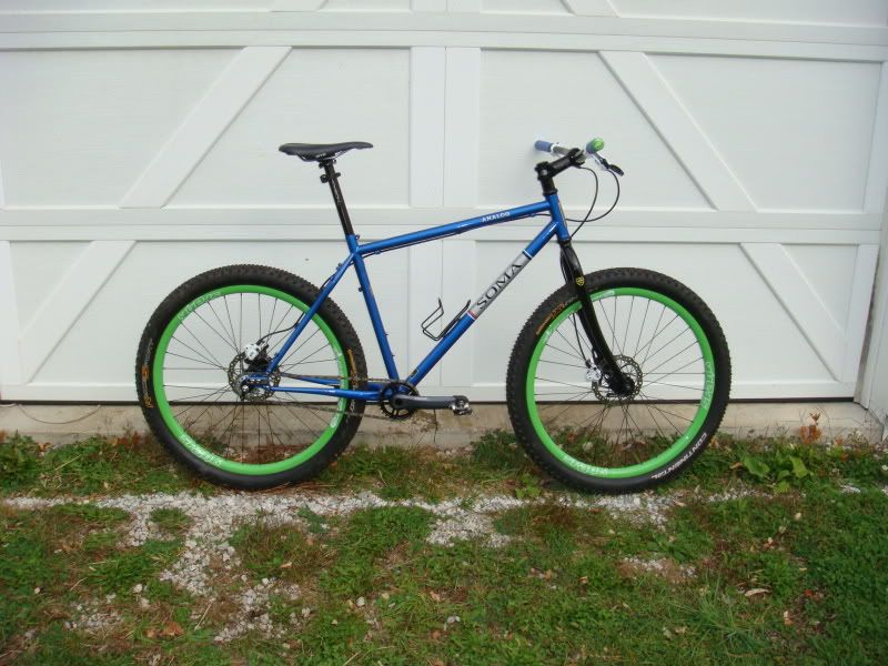

    So it's time to replace my beloved DMR trailstar Mk3.... living in Nelson NZ where the trails are steep the H/A is just too steep 72 with a fox van 125.
    I'm looking at a Soma analog which I will run with the van to take it out to about 69 degrees,
    also looking at the Surly 1x1 which is cheaper and heavier but comes with a rigid fork which I will get an extra crown race for so I can swap forks at will.... same geo as the analog so will be 71 with rigid for and 69 with the fox.
    Any body had any experience with either... good/ bad points etc...
    P.s. durability is a must as I'm a hard riding 260lbs

    I've had a Surly and a couple Somas (A B side, currently). You pinned the main differences between the brands, though I do like tarck dropouts a tittle bit more. Probably not enough to offset the relative lightness of the Soma.
    I'm 220 and I carry a dSLR on a lot of rides, so I can't lay out the abuse you can, but I doubt either will have a problem. Contact the manufacturer if you want a more accurate guess.

    I was debating between the 1x1 and Analog, and ended up with the Analog. Couldn't be happier.
    The bike is tons of fun. Compared to the 1x1, it's easier to take the rear wheel off/on, lighter, and I feel the details are a bit better. Besides, I love the color!

    I asked Soma, and they aren't making any more Analogs. So if you want one, get it while you can.
