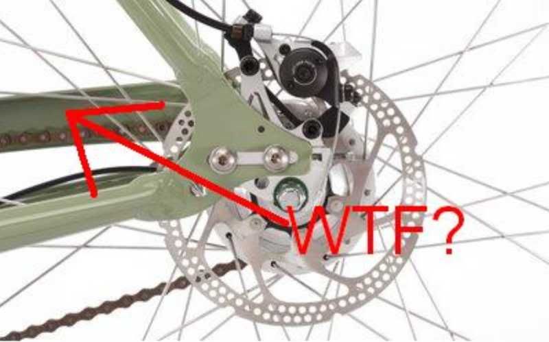

    Thanks, but this isn't a track bike with track-ends. It's got sliders, vertical dropouts, and a disc brake:

  • 02-02-2011
    Stevob
    Sorry, but it just has to be asked.
  • 02-02-2011
    Andy R
    That's an Alfine hub - there're acorn nuts ;)
  • 02-02-2011
    umarth
    You shoulda tacked this onto your other thread. Anywho, what you do, mid ride, is to open your quick release. After a couple bumps, you'll know how easy sliders will drop your rear wheel.
    The only issue with sliders on the MCF that I have is that switching tires and ratios takes longer than I have to give.
  • 02-02-2011
    Stevob
    I'm still none the wiser. That ain't no nut the arrow's pointing to. Looks like an extra brace above the chainstay, but where does it go to?
  • 02-02-2011
    umarth
    I am going to guess Swobo Baxter for the bike, the extra brace is a chainguard, painted to match the frame. But I'm no swobo expert....
  • 02-02-2011
    Stevob
    I'll pay that
  • 02-02-2011
    1SPD
    Uh yes, that is a chain guard! Its an internally geared hub (you can see the cable running along the far chainstay) so I am guessing it is a hybrid bike or something retro so it has a chainguard on it. I will also add that it is a cheap one judging by the lack of a QR on the rear wheel. Totally defeats the whole idea of having sliders imo though!

    Godless Communist
    FWIW, I pasted that photo from a Google search to illustrate to another member what the sliders were all about. It was the only pic I could find that showed both the sliders and the disc brake.
  • 02-02-2011
    Andy R
    It's an Alfine hub, I think - you can't use a QR with them anyway, as they have a solid axle.
    It's still just one spanner turn each side and the wheel's out - it takes longer to faff around with the shifter cable.
    Although there are nicer nuts that you could use than those Shimano acorn nuts.
  • 02-02-2011
    Stevob
    Chain guard is rather obvious now. I suppose that I wasn't really expecting to see one on a MTB. But like OP said, it's just a pic, not his.
