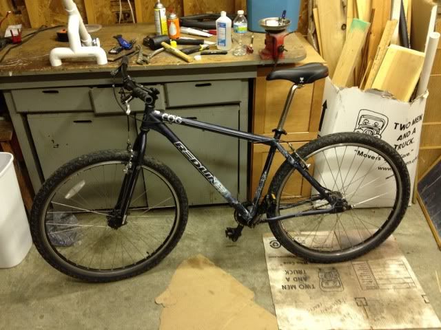

    I've been scowering Craigslist and other barter type sites for about a month looking for a singlespeed 29er... Finally stumbled on a Redline Monocog yesterday. Only issue is the seatpost is stuck, but I'm not too worried about it. The owner used a screwdriver to try and give it a bit of space to wiggle out, and the result was the fins in the top of the seatpost (has a slot in the rear of the tube) are bent out a tiny bit. He also marred up the seat post pretty bad with a pipe wrench so I think I'll just look for a replacement post and saddle. I don't think the damage will affect having a new seatpost put in but I guess we'll see. See pic below.
    I'm having trouble figuring out what year model it is, however. It has Tektro linear brakes, the slot in the top of the seat tube, and the frame color is a dark purple color. I'm curious what the gearing is, not sure if every year is the same but just curious what the specs are.
    No other pics so far but I'll throw some up later tonight or tomorrow morning when I start cleaning it up... I paid $140 for it, so I can't really complain. I can't wait to order some parts and hit the streets with it though!

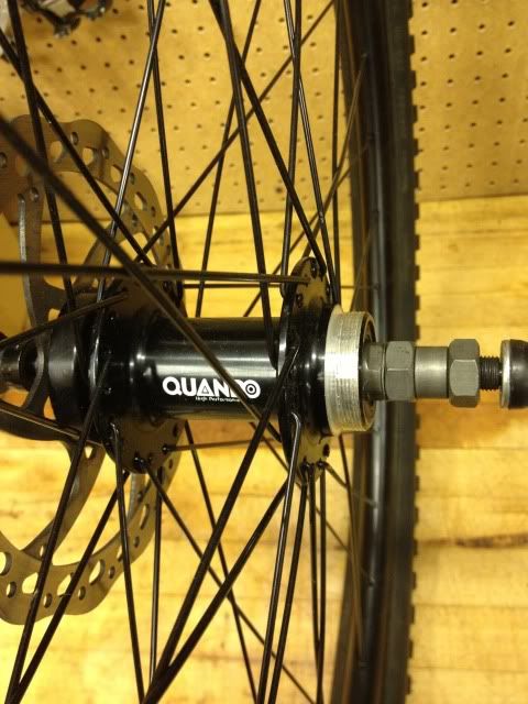

    Man, Craigslist is on the money today! Picking up a second set of wheels (with some knobby Innova tires, 160mm rotors and a singlespeed cog), set of Hayes disk brakes and levers, a stem and WTB seat, Suntour 32T front crank, and a Thompson 90mm stem for $150. Looks like I'll be under $300 for this thing afterall

    It may just be the angle but it looks like the other wheelset you picked up is for a 29er. Hope I'm wrong.
    If nothing else works you may be able to get the seatpost out by getting the bike really cold - I'm assuming its an aluminum post which will contract faster than the steel frame.
    Yeah I only carry cans cause I'm a weight weenie.
    2,188
    Quote Originally Posted by AlexCuse View Post
    I think both the wheels and bike are 29.

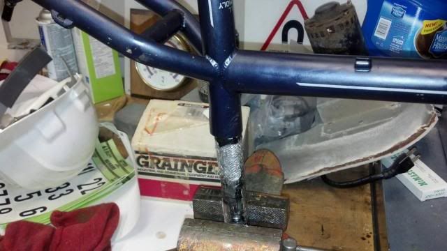

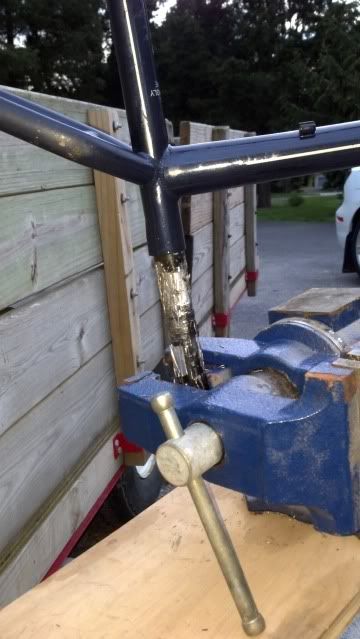

    Thanks... counted the teeth, I have a 33 chainring and 14 rear cog. I'll probably pick up an 18 and 20 cog to play with gearing.
    I was able to bust the post a little loose but not able to get it out. I can spin it with a pipe wrench but it won't come out at all. I even tried clamping a bench vice to it while it was suspended and spinning it with a pipe wrench, but no dice
    Then, from there I put a scissor jack between the vice and the frame to apply some force, still wouldn't budge. I'm not sure if taking it to a shop will benefit me more than what I'm already doing, but I'll keep spraying it down with PB blaster all week and go at it again next weekend I guess.

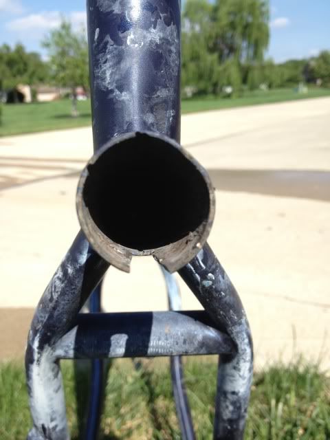

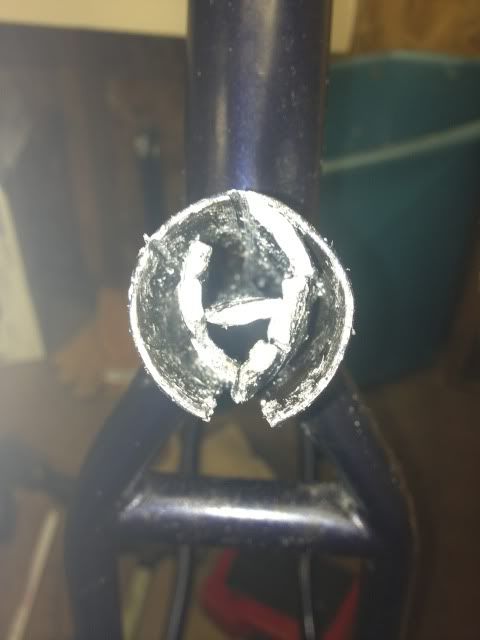

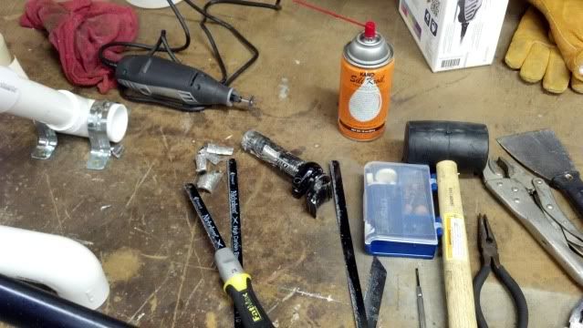

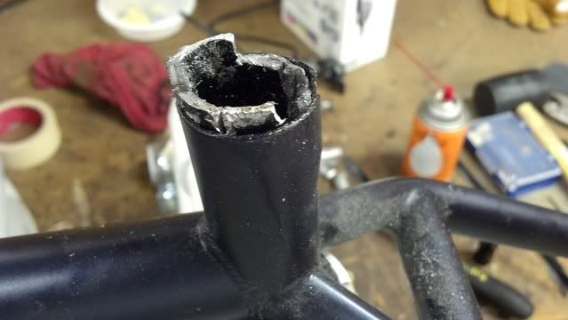

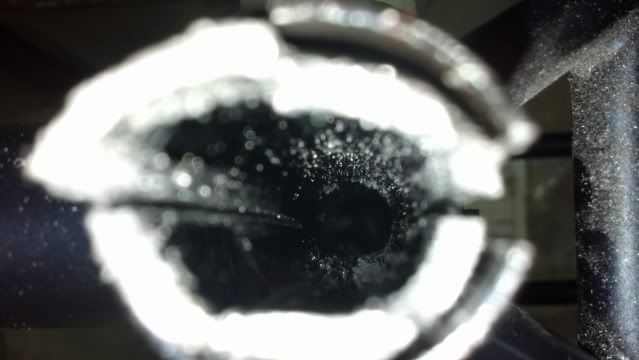

    Well after two hours, I'm more frustrated than ever. I used a hacksaw and cut all but about the top protruding two inches of the seatpost. From there, I used a dremel tool to make four cuts down the OUTSIDE of the protruding seatpost. Then, I cut down the INSIDE of the seatpost with the hacksaw.
    I thought for SURE this would work. Moved over to the bench mounted vice and clamped down, and the four "pedals" just cracked off at the base of the seat tube. Grrreeeeeeaaaaaaat, now I don't have anything to grip onto.
    So this is where I'm at now... I dulled/bent three hacksaw blades (I'm out of fresh ones), and went through two dremel wheels. There is juuuuuust enough protruding seatpost to grab onto once I make the cuts all the way through the inside of the seatpost. Once the inside cuts are made all the way through the post, I'll use some needle nose pliers and drive a wedge down the inside of the seat tube.
    Cuts with the hacksaw about 3/4 of the way down the inside of remaining seatpost... It goes about another inch further than what cuts I could make tonight.
    What remains up top....
    Aaaand what part of the work bench looks like... What I've removed on the left.
    All I can say is, this bike better be AWESOME when I'm finished with it. Looking down the seat tube, I can see a massive pile of metal shavings sitting on top of the bottom bracket, so I'll just go ahead and replace that once this post is out and I clean the inside of the frame out. Any suggestions on the bottom bracket replacement, or should I just use a "factory" replacement?

    Spraying a heap of oven cleaner into the seatpost would be easier on the upper arms. And the top tube.
    Grumps
    Reputation: A1an's Avatar
    1,927
    With it all mangled up the way it is you may want to try soaking in something like PB Blaster over night. Stuff works better than WD40 and now with everything moved around more of the penetrating lube may be able to get in there to loosen things up.

    Quote Originally Posted by Uncle Grumpy View Post
    Or get a machine shop to drill it out.
    If the bottom bracket isn't trashed, pull it out, clean and grease all threads and reuse it.
    Bottom brackets need to be mated to the type of crank you want to run. What sort of crank are you running (ie: square taper, ISIS, X-type), that will let us throw some suggestions.
    It's no consolation, but I'd like to say that your cuts are remarkably clean and straight. Sorry, just wanted to offer some encouragement in this time of need. Been there done that with a quilled BMX stem that wouldn't come out of a fork steerer. The stem was a cheapo so I cut the head off, and after soaking it in various things, resorted to the "cut slots into it and curl it in on itself" method. When it finally gave way with a crack, this rusty smoke just poured out. It was really spooky.
    Grumps
    THis. Careful pounding on it with a hammer.
    Grumps
    And this. Keep us posted.

    I'll give one more solid go at it with the hacksaw on Friday after work, trying my best to be patient with the process... I've been spraying it every day for two weeks or so with Liquid Wrench and WD40, probably should have been doing PB Blaster the whole time though haha
    Thanks everyone, I'll update Friday or Saturday morning if I make some progress... Otherwise I'll start calling around the area for machine shops who may have some suggestions.

    Ah sorry, forgot to update... Still stuck haha. I haven't really touched it, went fishing memorial day weekend and got food poisoning. I think I'll hack on it tonight, I know one of the cuts is all the way through on the top inch or so. The other four will probably require about 20 minutes of sawing each (if still necessary at that point).
    118
    I'm stuck, time to start shopping for caustic soda and the necessary tools to pull the bottom bracket. Worked on it for two more hours... TWO MORE HOURS last night. Started driving a screw driver down and got all but about 1/2 an inch before it stopped peeling off. Shortly after I took this pic, I tried with a smaller screw driver and it got stuck, and after about thirty minute trying to get that out I'm just going to douse it in caustic soda. I can't get a hack saw in it anymore, and I've almost sawed through the frame in one spot.
    I've easily spent 12 hours on this thing, 12 hours of solid sawing or prying on it. Should have just gone with caustic soda weeks ago.

    Wow,...that thing looks destroyed!!! I'd have taken it to a metal shop and gotten a bit of help. All the hours you put into it already are more $$$ than it's worth IMO. You really have patience my friend.
    Meh,...
    Super Moderator SuperModerator
    Reputation: driver bob's Avatar
    3,662
    With where you have it: Machine Shop - Bridgeport and a few $$$ to get it milled out.
    Reputation: henrymiller's Avatar
    136
    I had this problem with a KHS Solo-one I rescued on craigslist. Ended up using this Drano:
    Amazon.com: Drano Kitchen Crystals Drain Opener-18 oz.: Home & Kitchen
    I did not want to mess with straight caustic soda. If you tape up the frame and plug any holes this should work just fine. My butchered seatpost came out in 48 hours.

    I should probably take the bottom bracket out to avoid any possible damage, I'm assuming... I need to look into what tools I would need to get that out
    Reputation: akaBrowntown's Avatar
    Nov 2012
    454
    Did you get this out yet? Have you tried a slide hammer?
    I wouldnt have cut so much of the stem down, it would have given the machine shop more to work with.
    118
    Well I bought a bracket tool and crank puller from my LBS today ($45), and a can of those Drano crystals... Man that stuff is awesome. Tested with a small shaving and it disappeared in about 10 minutes. I got this in THE BAG, right?!?!
    Well I pulled the BB, and wrapped all the holes in duct tape... Put the frame inside a wheel barrel and let it roll. After about 30 seconds, all the duct tape started leaking.... and after about 15 minutes, I was out of Drano.
    So, it looks like that is going to work... I need to go out and get a few more cans of the stuff, and figure out a better way of plugging those holes. Any suggestions, other than duct tape? Maybe I'll ask the guy at Home Depot tomorrow morning what he would suggest to plug the holes (there's about a dozen of them)

    plug the holes with cut inner tubes. if you are going to do it upside-down, plug the seatpost hole with inner tube and wrap inner tube around the frame and seatpost junction.

    I bought some silicone caulking and two more cans of the Drano crystals today before work.. Never thought about flipping the bike over and using some innertube, I may try that. I'm not sure how that would work though for getting the Drano into the frame, the hole for the BB is kind of tucked up in there good

    Thanks, I'm ready to get it back together... I've got some cheap Promax disks and rotors laying around that I think I'll put on it for the time being, and need to get the wheels trued (or figure out how to do it myself haha)

    PB Blaster=ok. A 50/50 mix of acetone & ATF=Best Ever! Here's the cold, hard facts from the April/May 2007 edition of Machinist's Workshop. They did a test of penetrating oils where they measured the force required to loosen rusty test devices. Buy the issue if you want to see how they did the test. The results reported were interesting. The lower the number of pounds the better.
    Penetrating oil . Average load .. Price per fluid ounce
    None ................. 516 pounds .
    WD-40 .............. 238 pounds .. $0.25
    PB Blaster ......... 214 pounds .. $0.35
    Liquid Wrench ... 127 pounds .. $0.21
    Kano Kroil ........ 106 pounds .. $0.75
    ATF-Acetone mix.. 53 pounds .. $0.10

    Used some zip ties and plastic bags to cover up the bottom bracket housing and the headset, and put a bit of silicone in the other small holes in the frame. I was going to start mixing up some drano after letting the silicone dry, but I got distracted by a bottle of bourbon and some ginger ale. I'm off Tuesday also, so hopefully I'll get to using the drano again and we'll see if the zip-tie/plastic bag method works better than the duct tape did.
  72. #72
    Reputation: blackgriffen_1's Avatar
    May 2010
    165
    Upside down with an innertube tied off at one end and hose clamped around the top of the seat tube seems to be a really good idea, since then you can (if you have a small hand pump or exceptionally odd funnel) just fill the seat tube from the opening in the bottom bracket, then be able to slosh it around however much you want.
    Whatever the method, I so hope this works!!!
  73. #73
    118
    It's out!
    Used the upside down inner tube method, masked off other areas, and it was gone in about an hour. The white stuff on the frame is residue from the duct tape. Now I'll start piecing it back together, really the only thing to do it true the rear wheel. I have a 18t and 20t rear cog sitting in the garage but need to get a bigger chain. Any recommendations? Front crank is 33t, and the rear on it now is 14t
    Thanks for the support guys!

    Got it pieced back together, still needs some minor tweaks. And obviously the frame cleaned. It feels a bit small to me (I'm 6'4 and the frame I believe is a 17") but very nimble compared to my 21" 29er.
    This is my spare wheelset rear wheel... Can anyone tell me what I'd need to put a rear cog on it? A freewheel or something?

    Is that hub made for a threaded cluster? The SS freewheel may give you a very inboard chainline. BTW that frame will be way too small...careful going otb.

    On the nose, as it were. Definitely meant for a multispeed freewheel, and unfortunately it can't be redished over because then the rotor mount wouldn't match the caliper position. Even in the granny position of an ordinary cankset, that wouldn't be an ideal chainline.

    Ah so it'd need a hub specifically for a singlespeed?
    I guess I'll probably ditch the wheelset and start from scratch

    I bought it as a second bike to loan to others who want to ride with me... It's not ideal but in all reality it probably won't see much trail time with me on it. I'll measure it tonight when I get home but I'm fairly certain it's a 17'''
    I've only ridden it around the subdivision a little bit but it feels pretty good... It's definitely more nimble than my 21'' Motobecane Fantom X7, but I think some of that is the stem/bars. When I stand up I feel a bid further over the front tire than my 21'', and it's easier to lean back over the rear tire. The seat (as you can tell) is cranked up pretty high, but it feels natural pedalling with a full extention on the knees.
    Overall I like it... I'll like it more when I get the wheels trued (tried to myself and lost patience) and get a longer chain for the 18t rear cog! My other wheelset I think I'll just sell, or replace the rear hub for a singlespeed hub... Then it will be trail worthy.
  88. #88
    118
    Measured the seat tube from the middle of the BB to top of the seat tube and it was exactly 19 inches... Which is where I'm assuming it gets measured. Same place on my other bike was 21" but I could be mistaken. But I guess I was wrong, it's a 19inch frame... Same enough to feel quicker and more nimble than my 21", without sacrificing much cockpit room.
    I'm not well versed in the importance of frame geometry but this one feels pretty good
