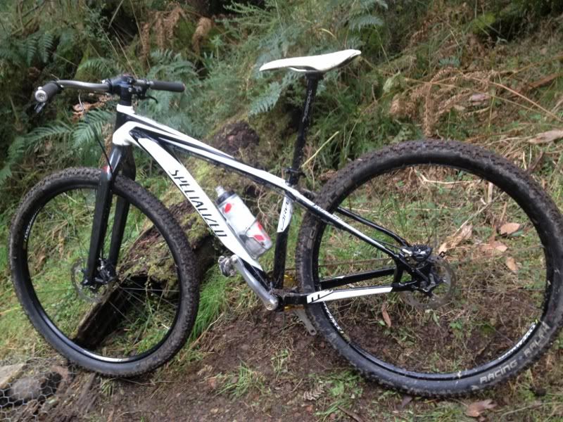

    Also take a look at the Specialized Carve SS, with a split shell ebb which is bullet proof and you'll never have a problem with it. I've never dropped a chain on mine, and that's the main reason I got one. That and the way it puts the power down.
    Here's my 2012 Carve SS. I've made a few changes since this pic, but nothing major. I got the frame only and custom built the rest.

    Carve
    Quote Originally Posted by Stevob View Post
    I was looking at that frame pretty hard last year. The pinch bolt EBB looks great. From some anecdotal reports I heard there might be concerns about lateral stiffness with this frame - I drop chains from flexy frames. I do have a Spec dealer in town. Also, the geo is spot on for what I'm looking for except the stays look a bit long.

    Quote Originally Posted by Miker J View Post
    Thanks.
    I'm only 145# so I can't say that I'm the perfect frame flex investigation candidate, but I came off an El Mariachi which dropped chains all the freakin time. I swapped the entire drivetrain onto this bike and haven't dropped one since. Stays are 3mm longer than the other two you're looking at. 2013's are designed around a 100mm fork. 2012's used 80mm. Shorter head tubes now I think, to compensate.
    I ride a 2011 Rockhopper with the split BB. I'm 82kg and 6"2 and i haven't even had to retighten the chain since i first built the bike and adjusted the EBB.I've never dropped a chain either. I'm pretty happy with it, but it's my first SS and my first MTB so i don't really know any better The Highball is damn sexy though )

    I'm very surprised to hear reports of the specialized being flexy, every one of their frames I've ridden has been pretty stiff (SJ 29er, gold with the same EBB setup is the most recent).
