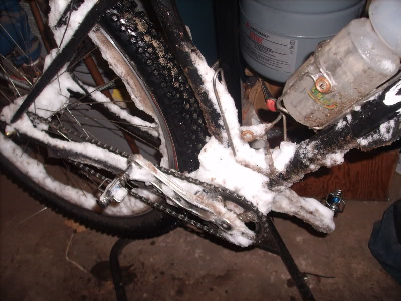

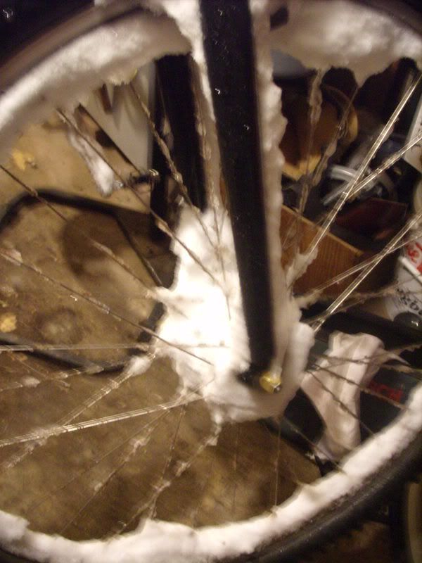

    I was one of the last rim brake hold outs in my area, but switched to discs the year Sheldon Brown passed away. Here's the reason:
    not so great in snow.
    I ran discs on a Karate Monkey for 4 years, and really had now issues with pad alignment as the chain elongates. I wouldn't make disc brakes a make or break on frame choice.
