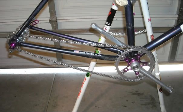

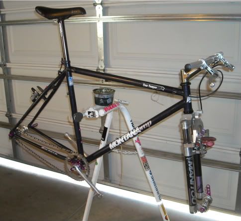

    Here's what I have so far. Do you remember the ninety's? This bike sure does. The frame is a KHS Montana Comp. I've held on to this because when I met my wife I was on hard times and had to sell my Kline and she gave me this as a birthday present while we were just dating. Anyway, the forks are Manitou 2's. Cranks are Topline. Levers are Avid Single Digit 2.0's. Brake canti's are Shimano XT. Hubs are Deore DX with Ringle skewers. Diacomp Aheadset. Controltech seatpost, and a no name stem, and bar. I even dug up some titanium bolts for the brakes and cranks.
    She's currently set up with a 36t chainring and a 14t cog. I need to scrounge up some rims I can lace up, and buy some grips, and pedals. Then I'll be set.

    Okay, I found some rims. There really on the cheap end (Alex x202's for $28.00 shipped), but the idea of this bike is to build it with as little out of wallet cost as possible. I went through my part boxes and came up with the spokes that I need. Now it's time to tear down the hubs for a good servicing.

    I think a 1/2 link would help. Is the SRAM powerlink the same as a 1/2 link?

    Quote Originally Posted by mustridebike
    Ummmmm.....
    You gonna take that thing offroad?
    That's a pretty big ratio...

    Right, started thinking about that myself, after all we do live on a hill so climbing is inevitable. So I did some playing around with the Magic Gear Calculator and using the cogs I have available I switched it out to a 36/23 (1.57:1). That's the best fit chain wise. I'd like to use a 19 and shorten the chain by a link, but I haven't been able to dig one up yet. I did find some brake cables, so I won't need to buy those. That's helps, especially since my wife had to layout $300.00 for eyeglasses yesterday.

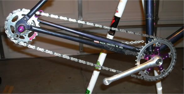

    A half link is different than a power link. A power link connects two female sides whereas a half link conects a male to a female if that makes any sense. Here is a half link:

    Back from my run to JensonUSA. I was able to pick up a pair of IRC Mythos XC Slicks with folding bead, Grips, Jamis Flatboy pedals (a bit heavy for the bike, but since I want to be able to ride in any shoes they'll work great), and a 1/2 link all for $50.00.
    I put the 1/2 link on as soon as I got back and was able to change out the cog to a 21t (1.71:1 ration). This allowed for the axle to fit all the way into the dropouts, and still give excellent chain tension.

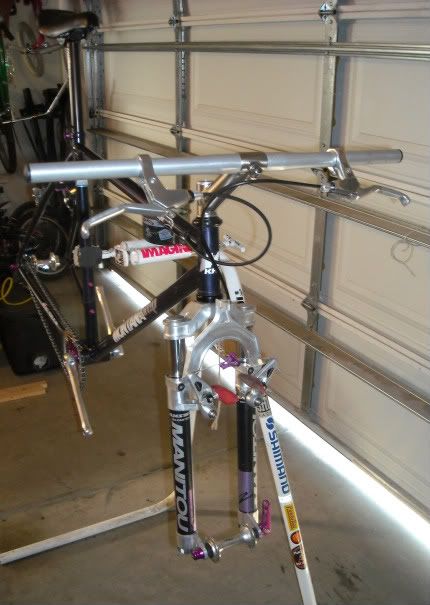

    How is that Manitou fork and can it be serviced? I was digging around in the old box of mtb forks at the co-op I volunteer at and found one but its completely seized up. Looks like its got 50-60mm of travel?

    There are rebuild kits on ebay but they're about $40-$50.00. I have modified mine to be rigid, which is pretty close to how they were when new...

    My forks are in great shape, but I have continued to service them over the years. I have read where some people have had the elastomers melt or break down and freeze up. Anyway, check out this link for info and parts on servicing old forks http://www.suspensionforkparts.net/e...iewCat&catId=8

    ... and if we just ... Project Finished!
    Well here she is. I had a bit of free time this morning, so I laced up the rear wheel, threw on the tube and tire, adjusted the brakes, and took her out for a test ride. Great Fun! I have the gearing at 36/21 (1.71:1) and she climbs well, but I feel like I could be peddling more on the flats. I'll give it some time and play with the gearing. It feels good to breath new life into an old and otherwise unused bike that I have always loved and could not part with.

    Just came in from the garage. I tried out an 18t cog, (that would make it 2:1) however I would have to run a tensioner and I don't want that. A 19t might work, but I don't have one on hand. As for now, the 21t is a perfect fit with the 1/2 link and it feels good on my bad knees. So I guess I'll leave it for now.
