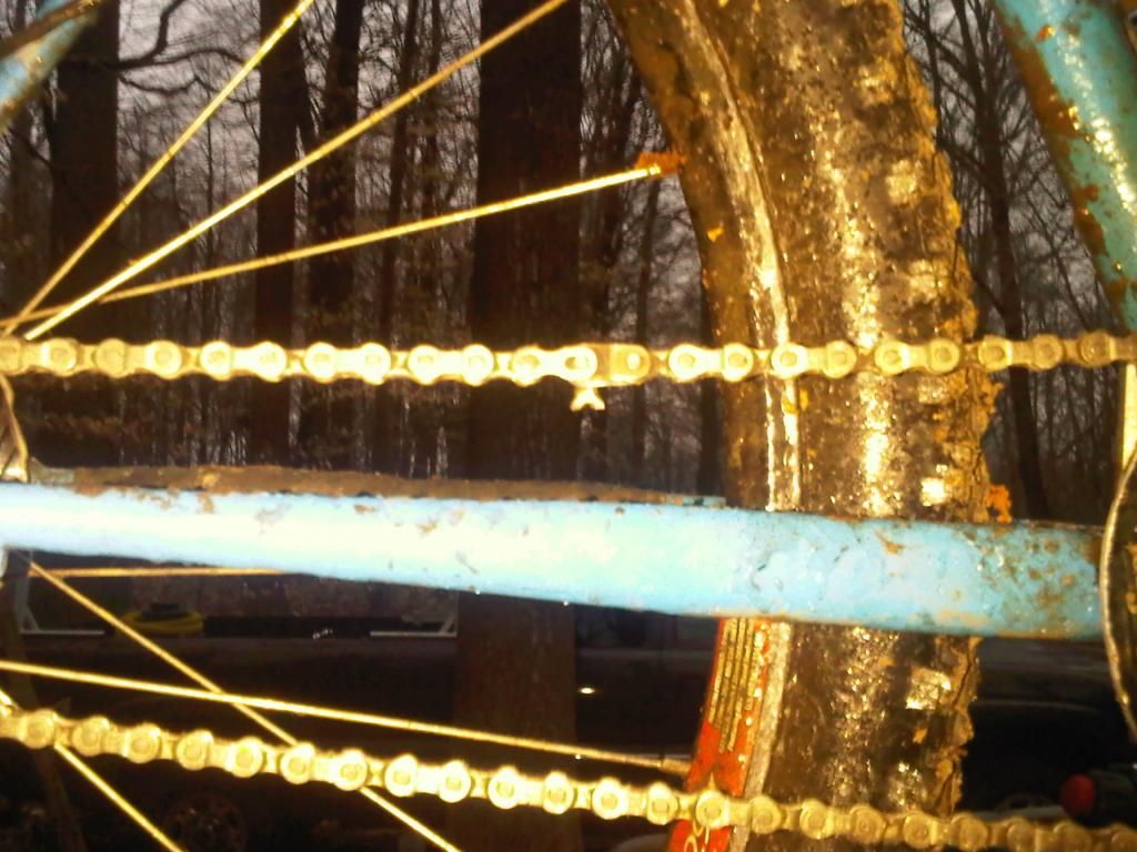

    The other day I went out for a spirited dawn patrol the other day and my chain was popping every revolution. At first I dismissed it as mud or ice, but when it persisted I started to soften up on the climbs and finally decided to let the group drop me and head straight back to the car. Walked some of the steeper hills. When I got back to the car (the sun had come up by then) I saw this:
    I don't know how that held! On a wing and a prayer, as they say. When I installed the chain with the half-link, the powerlink is a little tight. Not tight at the pin, but tight as in the plate just barely rubs the bend in the half-link so that if you wanted to remove the powerlink by squeezing the plates together and then pulling, you can't squeeze the plates together. Make sense? Seemed to have enough motion at the pin, and the chain worked for a good 4 months of regular hard riding, but I think there was enough extra strain on that powerlink plate to eventually lead to failure.
    So that brings us to why I'm running two powerlinks. I cut the powerlink/half-link out and replaced it with a powerlink-link-powerlink. When I had initially installed the chain I was running a 32-20, but now it's a 32-19, so that along with a little bit of chain stretch allowed me to avoid the need for a half link.

    Bmoreken, holy crap that was lucky, never seen one fail before,(nice picture too) would agree with you how it happened, lucky it held up, seen riders launched over the bars when chain snapped trying to power uphill, not nice.
    Put my snaps down to picking up small sharp stones in mud into the drivetrain, when it goes round the sprocket, if the side plate riveting is weak it bursts the link open.
    Lucky escape fella.
