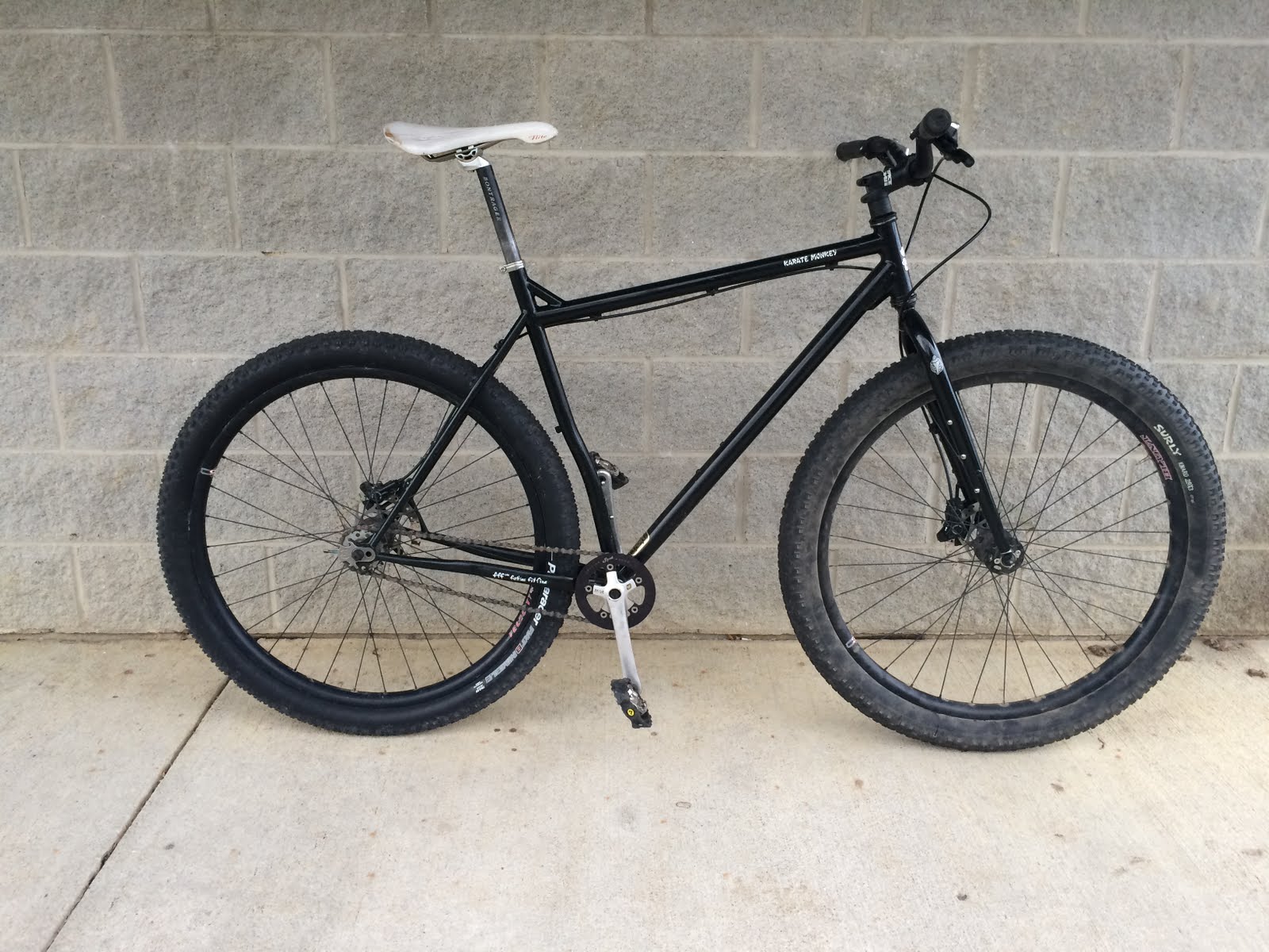

    not sure where to post this but a lot of ss riders are rigid and rigid riders like volume.
    im building a karate monkey and i want a fast high volume tire. not worried too much about grip as im a fair weather rider on buff singletrack. so fast and high volume. something around 2.5 width ish. going on a wheelset with 30mm inside width.
    if this doesnt exist i think ill try to fit a chupacabra on a 40mm interior rim. but id like to keep weight down a bit if possible

    Maxxis Ardent 2.4 is big
    Schwalbe Magic Mary 2.35 is way bigger than 2.35
    The New Schwalbe Nobby Nic 2.6 is big.
    Ive had both the Ardent and Nic, both good tires that were (for me) durable and notably more cush than a 2.3 or many other (small) 2.4's
    I liked them both, but they aren't even in the same league as a 3.0 on an i40 rim for plush and neither was especially fast rolling. Not bad, but not "fast".
    The only way you're gonna get a chupa in a KM is dropping down to 27.5+ i40 is (IMO) a perfect width for 3.0.

    there are people that are running 29x3 on the new (2017) karate monkey. ive been researching a lot and originally wanted a krampus but its killimg me that i cant put 2 bottles inside the triangle (i know its nit picking) then once i saw that the new km would fit the chupacabra i started leaning that way.

    Fair enough. I know a guy with an older KM, it isn't even close to fitting a 3.0, and Surly's site says 29x2.5 max, so I just guessed.
    I personally found that volume was less important on the rear than front on a rigid. I spent a bit of time with a suspension fork that only cleared a 2.6, so I ran a NN2.6 front and a NN 2.6 rear, or an Ardent 2.4 rear. Some rides I went rigid and actually ran a Chronicle front and an Ardent rear for a while. Moving up to a Chronicle rear improved traction, but honestly didn't help the comfort as much as I thought it would. Sue it was there, but paled in comparison to the difference between a 2.4 and 3.0 on the front.
    I understand about the bottle thing. My Vassago has two bottle mounts, but the TT is so low, the back cage can only fit a small bottle, and both cages have to be side draw. It's the only thing I don't love about my bike, but I make do because I'm on the fence between Small and Med frame sizes and was able to get the small in Dec, or wait 6 months for a Med.
    I gave up on bottles and just make do with a camelbak.

    A buddy of mine got a set of 2.6 Nobby Nics from some German website that he translated... was seriously wondering how legit it was but they ended up coming in. I am personally not a fan of the NN but he seems to like them, and they fit fine on his Karate Monkey.
    One thing I noticed is that they really don't look any bigger than my 2.4 Vittoria Goma. I think for a 2.6 they are pretty low volume.
    Aug 2010
    855
    most of the bigger "non-plus" tires weigh in about the same as chupacabra or wtb ranger 3.0 tires. In my experience, 29x3.0 is faster and more fun on a rigid bike than any other tire size by a LOT. Those two tires are fast rolling too. Just my .02$
    2,828
    The fat be nimble isn't anywhere near 29x3 and might work. It rolls okay, but isn't that good if you're heavy and hitting rock gardens.
    Maxxis ikon is fast rolling and comes in the larger volume. I think Conti x King does too? Also the maxxis rekon 29x2.6 is supposed to be out this summer.

    i think the rekon in 29x2.6 may be my perfect tire!

    Only real 2.6 tire out now is the Nobby Nic. It's a great all around tire and true to size and weight. I've got 400+ miles on mine.

    Personally, I thought the Chupacabra was a little lite on tread. Then after riding a 29x3.0 on the front of my rigid SS for about 600 miles realized it works quite well. I ride lots of rocks and haven't sliced a sidewall yet. Set up on Stand Flow MK3, running tubeless at at 11 psi. Fantastic traction and rolls over anything.
    I also have the 27.5 x 2.8 version of the Chupacabra and it handles similarly. Although mounted on i40 rims, the casing is as wide as the knobs. Keep thinking it may slice, but hasn't happened yet.
    I believe the WW by WTB is still available. But it fails in comparison to what it was when it was the LT version.
    Funny that WTB redesigned that tire when it was perfect as it was. They're probably kicking themselves now that they didn't keep it. Everyone is racing to get a tire to market with that volume now.

    The FBN 3.0 will fit (on a Blunt 35 rim), but it rubbed in hard corners, in my experience.
    I currently run an Ikon 2.35, which is still comfortably plump, and the FBN on the front. That's a pretty fast feeling combination:
    (I've since lost the drop bars, too much reach)
