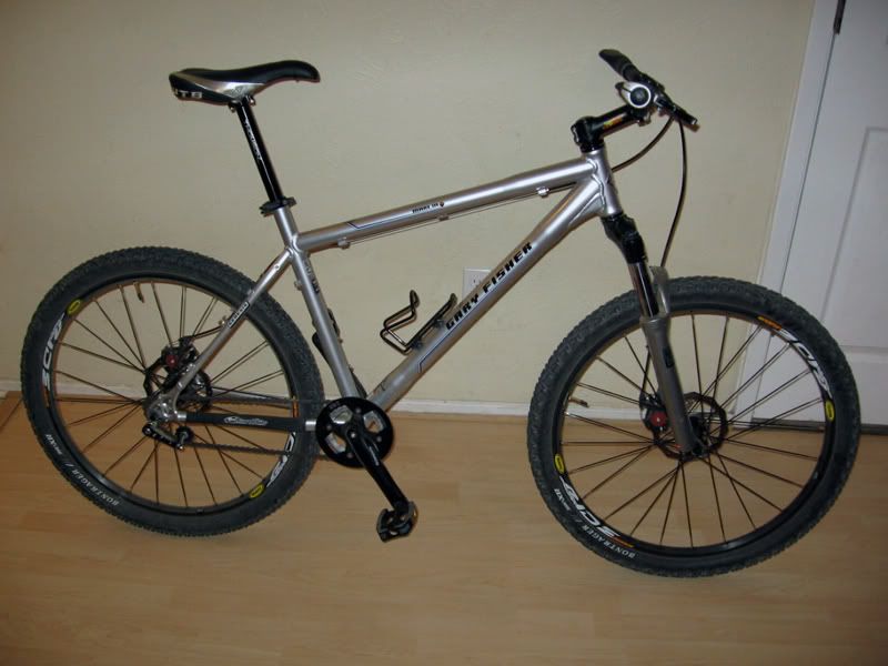

    Converted my hardtail to a single speed over the weekend and rode it for the first time. This is bad. Very very very bad. I had sooooo much fun, I didn't want to get off! I say this is bad, because I am building a new AM bike that I spent 6-months buying parts for and now I have NO MOTIVATION to build it after this weekend.
    I will be using this bike for 50% trail riding and 50% biking my dogs 2-10 miles every morning (missed 4 days in three years). I say biking them, but they pull me a lot (American Bulldog and Boxer), which is why you see "their" water bottle holder, dog pedals, and dog tires in the pics. I use clipless with the trails, Camelback, and better tires.

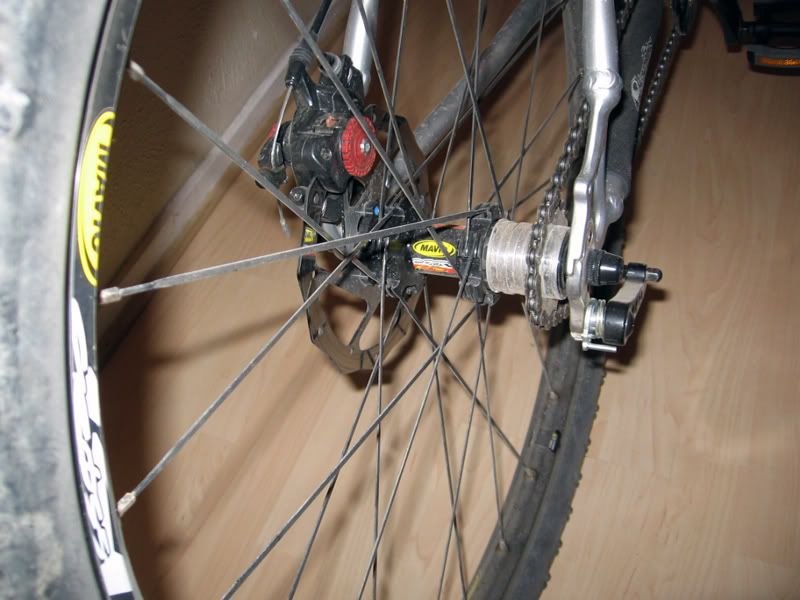

    I am currently running 32:16 and cleared everything but two hills at the most aggressive place I will probably ride it at. I even cleared several spots that the geared folk were walking (feels too good). I just bought a nice new 34t Blackspire mono veloce chainring for the front (as the current one is pretty beat up) and need to figure out the rear gear. Would a 34:18 be similar to the 32:16? Still learning this gear ratio stuff and would like to gain just a hair of better climbing ability.
    I know someone will say remove the bashguard, but there is a monster tree that I like to whip over while most people go around it and that thing helps be glide right across it. Also helps for pant leg when biking the dogs.
    Only other change I need to make is to find a stem that has a very low profile for attaching to the fork. This fork is cut a little short (got it for next to nothing), and I'd like a different size stem but the steerer tube is short. Any ideas would be great.

    34:17 is closer to 32:16, they're both 2:1 ratios. There's a good gear calculator on Sheldon Brown's website here - http://www.sheldonbrown.com/gears/

    Speaking VERY roughly, 2 teeth on the ring makes a similar difference as 1 tooth on the cog. Except the opposite plus / minuswise. That is to say if you add 2 to the ring, you'd get roughly the same gear as if you subtracted 1 from the cog.

    After posting this I found a thread talking about FSA's 35 mm stack height, and measured that I currently had 40 mm, so I placed an order for FSA OS-150 that I found on BlueSky for $25.
    Yea, I have a Cane Creek S8 right now . . . hopefully this 5 mm I gain is enough, but if not, headset next. Thx.

    1.)Try 32/18 to start with, go up from there. I run 34/19 or 34/21, depending on the terrain.
    2.)Your old style Surly Singleator will do you better if you change the spring and configuration to pushing up, rather than down. Think it's a $4.00 part.
    3.)Sux when the steerer tube's cut off too short. Your only option is a riser stem and/or a bar with more rise. Had to play with mine; ended up with an Easton EA50 DH bar with 50mm rise, and an EA30 stem, 6 degree rise. Feels right, finally. Actually could use the bars about 1" higher, but when I convert it to a 96'er, that'll do that...
    4)Nice bike! We've got a lot of the same parts, only mine's a rigid.
