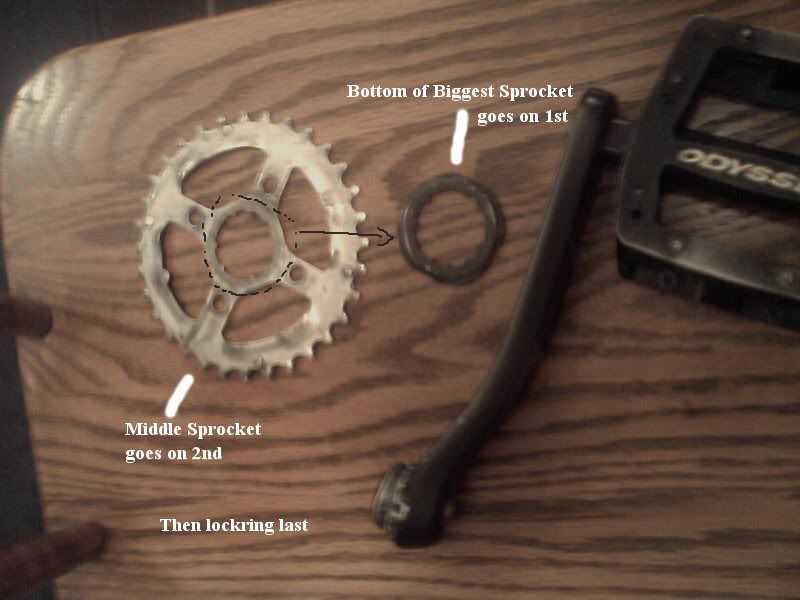

    there it is. sorry for low quality pics.
    I had to use a bit of the front sprocket as you can see (black square) to push onto the crank.
    then the middle gear went into the right spot on the crank and the lock nut deal behind it held it inplace.
    if you dont use that little bit of the front sprocket, you will never be able to tighten the sprocket all the way. it'll just wobble.

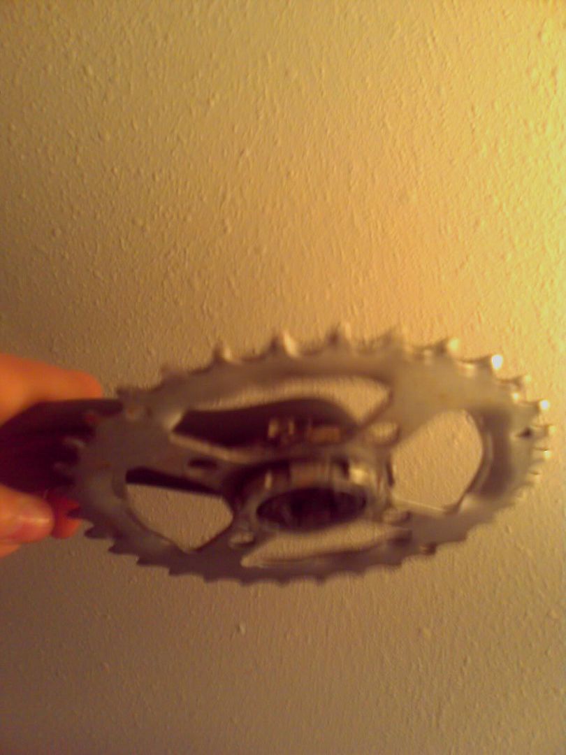

    maybe this will help a little, also
