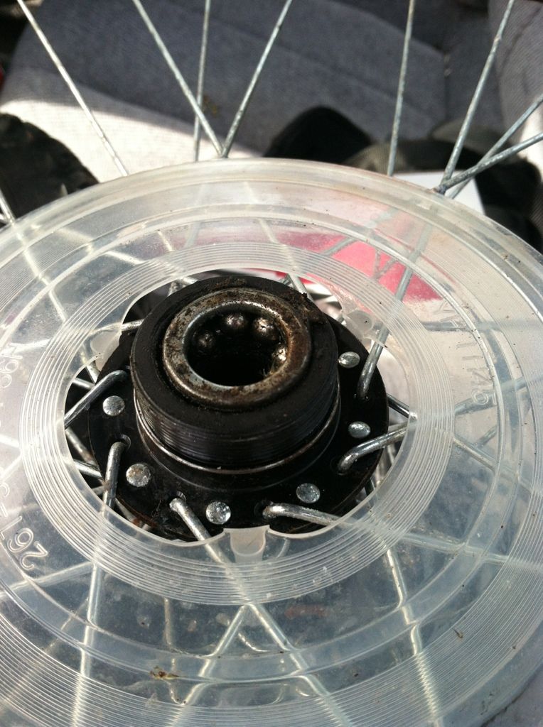

    Well i got tge cassette off to find this threaded hub
    Not quite sure about how to go about putting on a rear cog, and what parts ill need

    You can thread on a BMX freewheel, but you will have to re-dish the wheel.

    I understand the bmx freewheel part, but i dont get what you mean by redishing the wheel

    Adjust the spoke to center the rim after you have the right chainline.

    Don't do either one of those. Number 1 won't even work on your hub, and the Dicta freewheel sucks - you will want more engagement pawls. Minimum, an ACS or Shimano freewheel.
    Re-dishing the wheel involves a truing stand (best, although I have done it on the bike) and a correct spoke wrench. When you remove the cassette freewheel, you will notice the rim will be out of line when it sits in the frame. To get it re-aligned, you will need to re-dish, or move the rim over (usually by an inch). Otherwise, the wheel will need to sit in the frame crooked for the rim to be centered.
    It is the process of loosening one side, incrementally (like 1/4 turns) of the spokes and tightening the other side, which will "pull" the rim over until it sits center in the frame. You will also need to re-center the hub axle, because the drive side will be too long. Truing the wheel is always necessary when re-dishing the rim for an SS conversion.
    If you replace the rear wheel with one that has a free hub body, then you can use DMR SS conversion kit. Otherwise, the thread-on wheel will take some work. If you stick with the threaded hub conversion, it appears you will still need some kind of tensioner.
    Sheldon Brown (RIP) goes through this process. You should go to his site and look up "single speed conversion" before opening up a can of worms. It appears you're not sure of what to do.
    As far as the crankset is concerned, just yank the big and small chainrings, leaving the middle, and you're gold. Understand that you will need to probably get SS chainring bolts, since the stock ones are too long once you yank the big ring.
    I'd tackle this wheel situation first. Work big to small.
