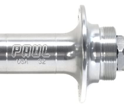

    Quote Originally Posted by ISuckAtRiding
    Ideally, there should be a precise surface for the freewheel to locate on the hub instead of relying on the threads.
    Yep, notice on this Paul hub, the surface the freewheel tightens against is shaped to center it.
    Mtbr Forum Sponsor - Homebrewed Components
    2,419
    Quote Originally Posted by Zanetti
    all i see are threads and an undercut... The freewheel just butts up against a flat surface just like every other hub as far as i can tell. The shoulder and fillet are just part of the hub, they really dont interface with the freewheel.
    All 26.5" all the time!
    Reputation: Zanetti's Avatar
    1,855
    It may be difficult to see since the photo is grainy, but I just built up a set of wheels with Paul hubs. There is an angular cut (I'd guess 82 degrees) to center the freewwheel on the hub shell. It wasn't faced 90 degrees perpendicular to the hub axle.
    2,419
    ah ok i couldnt see that in the picture.
