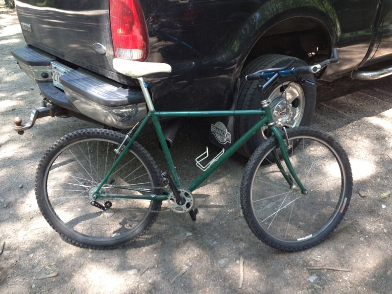

    So I was able to acquire all the parts needed to convert the ole Ritchey into a SS. I went with 32x22 gearing, as a starting point. There was a lot more work than I thought to convert the frame, but I ran into some good luck here and there.
    Here is the sorta final product:
    I say sorta, because after not taking it for a ride, despite being all geared up (camelback tube clogged with the liner - but that is another story) I found an old wheelset in the garage so those are not in the pic.
    My riding buddies always used to call this bike the frankenbike, since it originally had the Alsop Frankenstem. It now has parts from several bikes and eras, most of which I still had in the tub o parts.
    Set Up:
    Ritchey P23
    XT hubs on Mavic 517's
    Velociraptor front, and Smoke Classic rear
    LX V Brakes
    super long Cannondale CODA bar ends
    Original seat, seatpost, and fork
    Avid Brake Levers

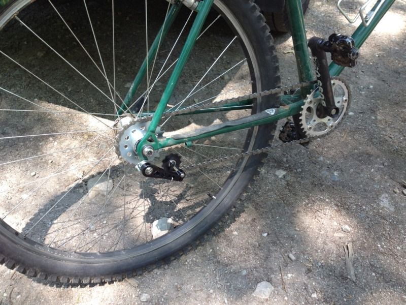

    Boss Cranks - Anyone know anything about these? The 32 tooth salsa chainring fit perfectly without needing shorter bolts, so I could run without the large ring or bash guard.
    Nashbar SS conversion kit
    Surly 22t cog
    SRAM chain

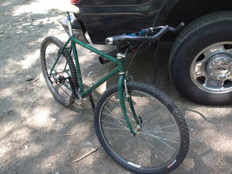

    One more pic of the bike
    One of the drivetrain
