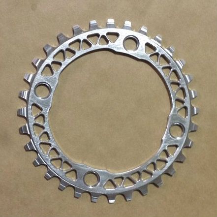

    I have been riding my Raleigh XXIX for 5 years and have wanting to make a chainring for it. I have all of the tools, but it has been hard to get around to it while keeping up with the regular jobs. I finally got one done this week. Took it for a spin this morning.
    It's a 33T to replace the one Truvativ ring that came on the bike originally.

    Did you CNC or use a rotary table?

    I don't have a gram scale. I put it on my postal scale and it weighs somewhere between 40-50 grams. I didn't put much effort into making it light. Just wanted to try out the tooth profile. It worked fine on a quick 6-mile ride this morning.
    This one is machined out of 1/8" thick (3mm) 6061 material that I had on the shelf. I did it in two setups on my Fadal CNC mill. I ran the mounting holes, teeth and center bore in one operation and flipped it over to cut the step and ramp on the teeth on the other side. So it is very concentric: no runout. The teeth are machined to 2mm thickness. I will probably redo it with thicker teeth for the wider chain on my SS.
    What I learned so far: I need more clearance to mount the ring easily without removing the crank arm. I was barely able to get it over the spider. So cutouts are necessary.

    How did you design it?

    I intend to get there before too long. I will not sell anything that I don't already have made. I know how that turns out. I need to get some 7075 material for strength and longevity.
    Quote Originally Posted by Mr.Magura View Post
    Magura
    Math and CAD. I used my old standby BobCAD V17. The software is 15 years old, but it's quick and efficient. For more complex stuff like fork crowns and 3D hot rod parts, I use a newer version of BobCAD.

    I will check into coatings that will hold up once I get some 7075. This piece is just a test mule to check geometry and function. I really want to see how long 6061 will last, just for fun.

    Quote Originally Posted by icantdrive65 View Post
    So, the hard way just like me

    Yeah, but I cheated in the execution. I have CNC mills. Your rotary table chainring is impressive.
    I honestly was a little lost at first, but I found some very helpful info on drawing sprockets that got me rolling.
    It's rotary table + file
    I'll ask my drawing guy if there is a shortcut, and post it if he has something up the sleeve.
    I couldn't make a CAD drawing if my life depended on it. He is on the other hand quite good.
    When I made mine, I just had the numbers on a Post-It. Not the way it's going to be in the future. Made like 3 or 4 that way.

    While the machine was set up, I ran a revised version of the bash guard I have had on my Blur.

    This one is ridiculously light. It looks like it barely tips the scale over to .03 kg, so I'm guessing low 30s until I weigh it on an accurate scale.

    I did a similar design years ago. It turned out to be too weak, and collapsed under heavy load.
    I did a revised version later where I did the cutouts pretty much the same, but with an end mill with a radius from both sides, and left a thin wall in the center. That one worked well.
    Later I started using a mix of aluminum and composites, as that seems to offer a better weight to strength ratio.
    Soon I'll have to make some more, as I'm about to be out of rings. I guess I'll look in the direction of the Hope design, but with carbon in the mix.

    Were the cutouts triangular like mine? How long did it take for the chainring to fail?
    I made the lightweight one a 32T and put it on my Blur. I am itching to get out and ride it, but the rain is hitting us pretty hard here.
    [/IMG]
    It looked very similar.
    It failed first time it hit a log.
    It looked good though till it failed.
    I downloaded some sprocket files from here to get me started:
    CAD files Chain wheels
    Still talking with the laser cutters - they won't do any machining, think flat 2.5mm will work?
    That's in a terrible language, and they want me to make a user ??
    Any chance we can exchange those files as emails?
    If you just have them made according to the thickness you need the teeth (8-9-10sp), and make the rest of composites, you're good to go.

    Sure, send me a pmail with what you need (# teeth, file format). Right now I've got 32/33/34 teeth in ProE format.
    I'm building for a singlespeed with a 3/32" (2.3mm) chain, so if that's tight I'll either file the teeth the 0.2mm or throw on a 1/8" (3.2mm) chain.
    @icantdrive - how did you figure out the height/squareness of the teeth and how does it perform? I rounded mine off (in CAD)
    I could hardly imagine 2.5mm would be an issue with a 3/32" chain. I have made mine 2.4 as I recall. The height/ squareness, is a matter of entry/exit angle of the chain.
    In a cad system, the easy way is to draw a chain on the smallest rear you intend to use it with. Then you can see if the edges collides on entry/exit.
    I just copied what is already out there and working. It works great so far. I have not had much chance to test it out since the first ride. We are getting hit with a pretty decent storm right now.

    Are you cutting these from sheet stock or off the end of a billet?
    Reason I ask if sheet stock where are you getting your supplies. I need a new supplier for making skid pans for Moto Trials bikes! Mine has stopped stocking sheet aluminum, I guess the race car business dropped off for him.
    On another note, love your designs so far, the bash guard is beefy and should handle a lot of abuse.
    Thanks. I have just been using 1/8" 6061 sheet that I have on the shelf. I am having trouble finding a supplier for thin 7075 sheet. At least an affordable one.

    The question is: Do people want a lightweight chainring or do they want one that stands up to abuse? Aren't bash guards for people who want to grind logs and rocks? Just trying to find the balance. Now I want to mount it on the XXIX without a bash guard.
    I took the lightweight ring out for a spin on my Blur today. I forgot what it's like to shift from the granny gear to the middle without all the pins and ramps on modern chainrings.
    True. I just don't like stuff that breaks if you look at it wrong.
    I know for a fact, that loads of the people on MTBR don't care, as long as it's light.
    I just gave you my experience. I didn't say it was bad or wrong.
    Personally, I just hate when equipment fails, thus that design went in the bin real quick.
    To get reasonable shifting, just mount 3 or 4 pins, that helps a lot.
    Magura

    I'd gladly test 1
    Reputation: TheMachinist's Avatar
    Feb 2007
    1,420
    Quote Originally Posted by sasquatch rides a SS View Post
    If anybody needs any testing done on their chainrings I would gladly do the job for you
    BCD and tooth count? I could use some outside R&D. I have been riding the lightweight ring on both of my bikes, but can't get out much between rainstorms for the last week.
    Feb 2007
    1,420
    Quote Originally Posted by ozzybmx View Post
    You are a prime candidate to take on HBC's client list.... have a go at a 29t spiderless middleburn and i'll send you some cash and test it for you
    One speedbump I am running into is that I don't have all of these different cranksets to measure and test fit for splined chainrings. I honestly don't know much about them.
    I do have an old XTR crankset circa ~2000-2002. Too bad those are out of vogue.

    Thanks. It's amazing how anodizing really finishes them off nicely. Next for the final machining accents.
    I have been running the lightweight rings on two different bikes for the last few weeks and they are holding up well. Of course, I'm not getting a whole lot of riding in between rainstorms. I like to let the trails dry out a little before I ride them. I can even get halfway decent shifting from granny to the 32T on my Blur.
