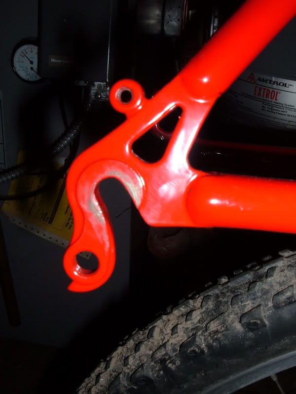

    I filed the dropouts on a '96 Stumpjumper with good success. With a half-link I had just enough adjustment for the life of a chain.

    Here's a picture:
