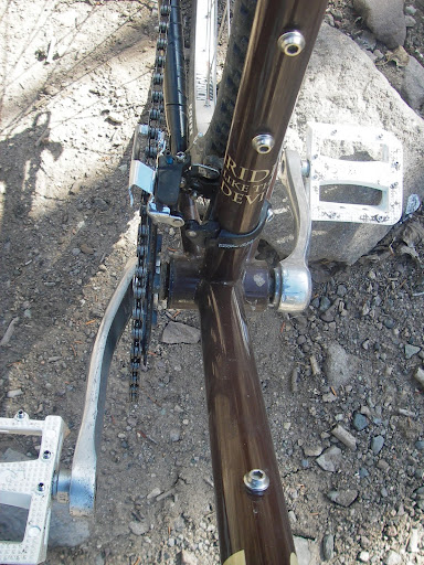

    Sugino AP:
    <table style="width:auto;"><tr><td><a href="https://picasaweb.google.com/lh/photo/hHJFDicvqEvpjOuymgjMnA?feat=embedwebsite"><img src="https://lh4.ggpht.com/_sUSecbkOXA8/S_3vN22TF7I/AAAAAAAALTg/QEIcboEhYdw/s144/DSC_0001-1.JPG" /></a></td></tr><tr><td style="font-family:arial,sans-serif; font-size:11px; text-align:right">From <a href="https://picasaweb.google.com/umarth/MyBikes?feat=embedwebsite">My Bikes</a></td></tr></table>
    pros:
    -They accept chainrings.
    -Also pedals.
    -175mm in length
    -shiny
    -around before the 29er fad infected e-riders.
    cons:
    -Embarrassing to weigh
    -Really narrow q factor (my heels hit each other when I pedal).

    Wait a minute... I used to have a pair of Sugino AT cranks and loved them. I don't remember the AP model but their ATs were well built and strong. I'd probably still be using them if only the arms were the correct length. Bet I've still got the ATs rattling around in the bottom of my parts bin.
    The LXs are a fine crank, too.

    Wait a minute... I used to have a pair of Sugino AT cranks and loved them. I don't remember the AP model but their ATs were well built and strong.--Sparty
    When I saw the cranks listed on craigslist, I was sure they were ATs. I got over there and they say 'AP.' I like 110bcd and I like 175mm(offroad) and they are kinda pretty.

    I'd make sure you can find a quality square taper BB with a long ass spindle (122mm or 127mm) before choosing either of those cranks.
    I don't mind a narrow q factor too much. I've been riding the Suginos for about eight months and they've been working great, but now my BB is shot, so I'm revisiting which cranks to ride.
