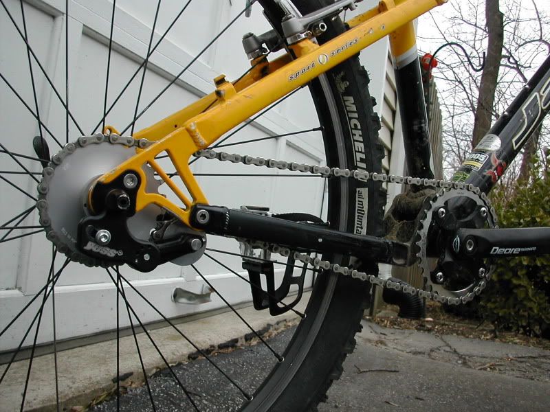

    A friend bought me a chain guide, will that work in place of a tensioner? Again, I am converting a single-pivot, full suspension Cake over to single speed.

    no, it would work on a hardtail (but even then, you would have to use like a half link chain to get it REEEALLY close, and even then it's limited)
    use a spring loaded tensioner that pushes up on the chain

    Seriously? Some of you guys worry about what a PVC spacer is gonna look like? Who cares what it looks like as long as you use a miter box and cut it straight. Do a nut-check. Chim Chim, check out a full-suspension chain tensioner from Yess. It's the one I use on my Jamis full suspension complete with KickAssCog from Endless Bike Co. and PVC spacer from Home Depot.

    You should run a guide/bash ring on the outside in place of the big ring. I would buy a rear cog with a wide base to keep it from cutting into the free hub. You will want to get a singulator and make sure the chain is long enough to not bind when the suspension is compressed. I would pop the shock off and cycle it through the travel to be sure.
    The other cool option is to just go 1x9. Many FS bikes don't work well when standing and SS requires plenty of that.
