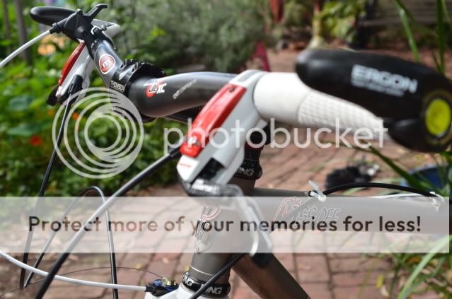

    I have ergon grips. Any issues with using them with carbon bars?
    Dec 2011
    10
    Quote Originally Posted by jekyll2003 View Post
    I have two Specialized single speeds one with Easton carbon bars, one with Specialized S-Works carbon bars and both have Ergon grips and barends on them and I've never had a problem.
