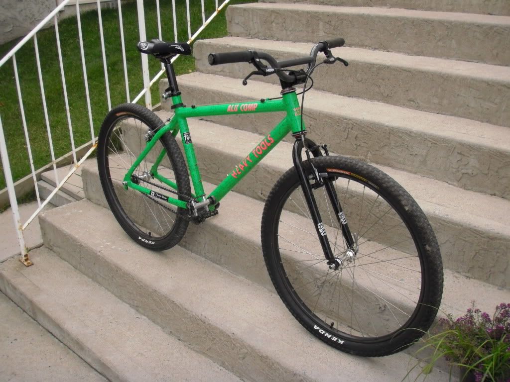

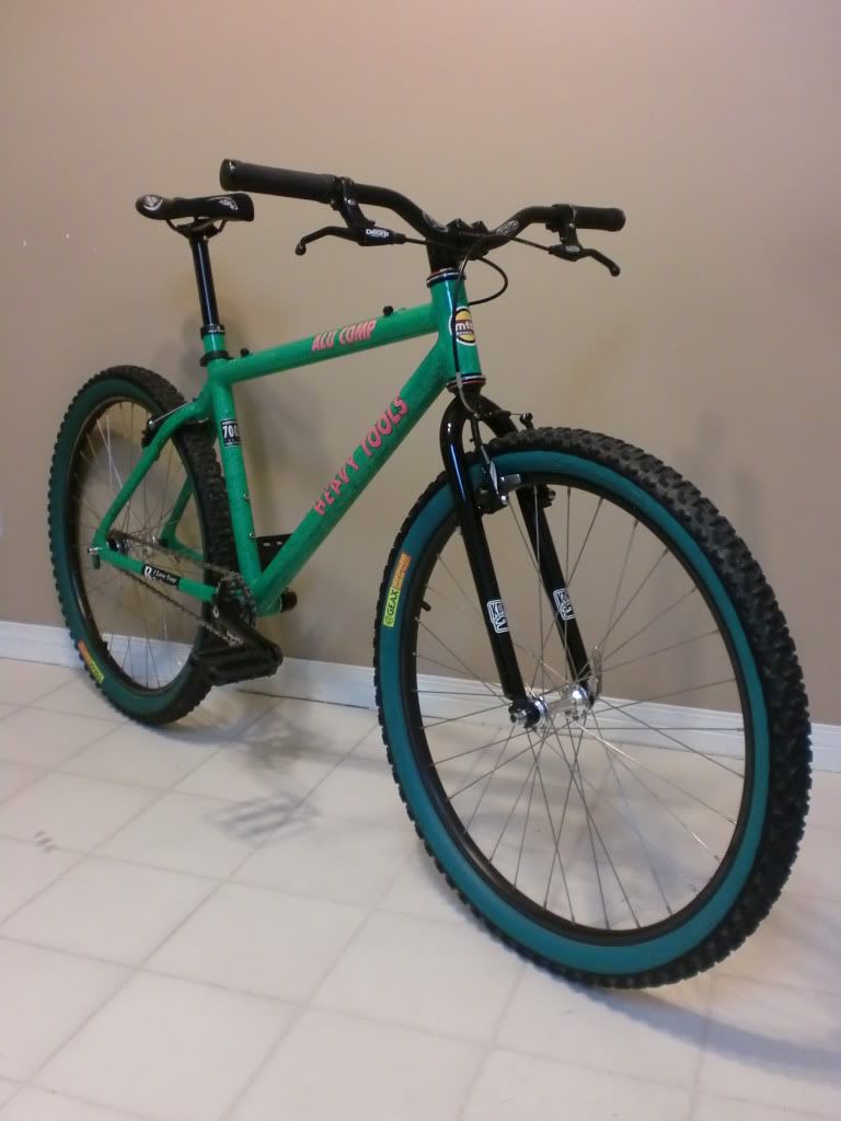

    I was running a 22x12 but I was going through chains FAST so now I run a 26x15. It seems to spin with a little less effort but that could just be in my head. I thought the pic with red rims was running the 26x15 but I was wrong, sorry.
    Attached Thumbnails Attached Thumbnails Anyone using 22t/24t chainrings??-img_0761.jpg
    Anyone using 22t/24t chainrings??-img_0400.jpg
