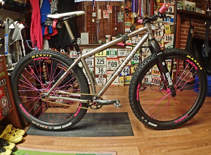

    500mm A-C Roca Roka ti fork with high 69'ish°/low 70'ish°:
    470mm A-C ENVE with 71° HTA:
    WWW.TEAMDICKY.COM
    If I was the op i'd drop this custom builder and try to buy Dicky's bike (or have a copy made.)
    Look at that thing! Short chainstays, low top tube, bent seat tube but straight at the top for a dropper. Drewl.

    I have 2 rigid SS bikes, my Sir9 has a steep 70 HTA with the Niner carbon fork. My Seven has 68.5 with the ENVE MTN fork (offset to the front)but I run fat 2.6 tires on i35 rims or 3" tire on i40 rims. So the HTA is actually closer to 67.5 or 68.
    Personally I enjoy the slacker HTA, the bikes are small and have short wheel base. True the slacker HTA takes a little more finesse on steep climbs but the descents are way better. The steeper HTA take more finesse on the descents.

    Coke, sounds like an interesting build you're working on. I like the decision to go 157mm for the rear, I did the same on my custom build last year. I'm just using a standard 157mm DT hub, don't know if any Super Boost hubs are actually available? It's the same as the old 157mm Downhill standard, so any of those hubs will work. I swap between SS and geared, and what I did was get a steel freehub for my DT hub. I keep the cassette on the original aluminum freehub, and put the SS cog and spacers on the steel one. Swapping is as easy as pulling one off and sliding the other one on. The flange spacing is not as wide on the old 157mm hubs as on the new Super boost, but at least it's symmetrical. I also managed to find a really rare and sweet DT Swiss 440FR 157mm singlespeed hub. I haven't done anything with it yet, but the flange spacing is huge, should build a bomber wheel!
    Also, what width BB are you going with? I went 83mm to better match up with the wider rear end, and that also allowed the builder to make the CS length even shorter, as it freed up precious room in the area. May be worth asking the builder about it.
    Oh yea, mine was build to also take 27.5x3.8 tires for my winter setup.
    Edit: Forgot to mention, I went with 68 deg. HTA and am very happy with it. I have to 'throw' it around a bit in the tight stuff, but otherwise all good. I also had my builder extend the headtube up so I could get my bars up high without tons of spacers.
