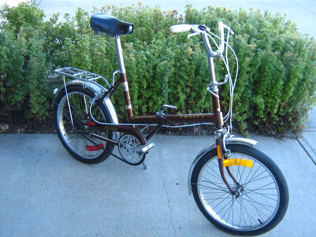

    It was 26 years ago since I rode my first bike which was a folding Panasonic singlespeed. That was my all around, do it all bike. My scars proved how I loved riding my bike on and off-road using only the commuter tires it came with.
    This brought up reincarnating this 30-year old Raleigh Twenty. I wanted to bring back old fun memories and convert this fully functional three speed into rideable off-road SS machine. Impossible? no. Challenging? yes. Waste of time and money? not unless you love what you are doing.

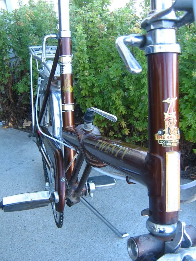

    Few of the challenges is to find a correct threaded BB and replace the cotterless cranks. Crank is in perfect condition but I wanted to give a modern taste to it, least of my worries but sits high on my priority if I can.
    At the moment, all the fenders, chainguard and some unwanted crap and reflectors are being removed. I have Holy Rollers ready for some off-roading action and still looking for more knobby tires that can handle loose gravel.
    Here's some of the before shots:
    This project is open for suggestions and hopefully turn out a success.

    Those are cottered, not cotterless (hence the cotters). Since it's british it should be fine with the standard 68mm BB. I probably wouldn't do much to it beyond restoring it and enjoying it as a cool old bike. You might ruin it and then what?

    nice project!
    i agree with schmucker, keep this one as an original restoration, that is a cool bike!

    It probably has the dreaded 68mm, 26tpi BB. I use the old cups and a new spindle with loose ball bearings. The other option is to tap the BB to 24tpi.

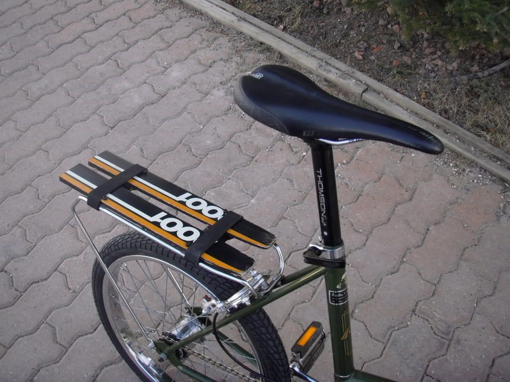

    Mini Utility complete
    The beastly mini utility is finally done with some finishing touches on the rear rack, made out of recycled telemark skis.
