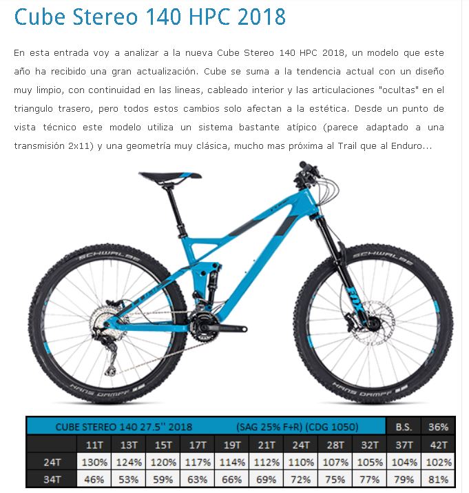

    I was actually JUST thinking this today, reflecting on my ride on Wednesday. It was the first ride with a 30t OneUp oval ring and it felt funny. I had a 32t round ring on Monday when I rode and that felt pretty good. I have a 32t round Oneup ring on the way for my XTR crankset, and I intend to compare them one after the other on the trail!
    As for does it "disrupt" as, i can't say, but it does change as depending on where the chain is on the oval. If we look at a 10t difference on an example bike, the change is about 2.5% per tooth in a climbing gear.
    Distance from center to bottom of chain on my bike
    32t round: 60mm
    30t oval max: 63mm
    30t oval min: 55mm
    So the as will change a bit depending on where the oval is in the stroke. But on the other hand, the chain tension is changing and should be less at higher as positions.
