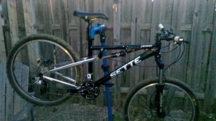

    The Build Process
    Bikerbob.com already already posted an excellent step-by-step tutorial on building up a full suspension frame, so I am skipping many of the details.
    First, the temporary donor bike a 2008 Rockhopper with nothing stock except for the crankset. I'm borrowing the wheels and fork for now until I save up some more money for Fox Float 100 and a new wheelset. I am thinking about Hope Pro IIs laced to Mavic XM 319 rims, but I am not positive yet. I like my hardtail, especially for trips to Rays, and I doubt the frame is worth much to resell anyway.
    The bare Derro frame, freshly unpacked. The quality is as I noted above, on par with other mid-range frames out there.
    The bottom bracket cups threaded on nicely and the crankset fit in nicely. I did NOT have the BB chased and faced. The parts fit as a they should and I am banking on the plastic spacers covering up any imperfection in the BB shell or powder coating. If I'm wrong, I'll be buying a new crankset and BB and I will get it faced then. I am crossing my fingers.
    The rear dropouts and hanger are true. I am still waiting for the part number for the replaceable hanger. That is something I like to have an extra on hand for emergencies. This is even more important to me if I can't stop by the LBS and find the right hanger.
    The cable routing follows the bottom side of the top tube from the cockpit. The frame uses a top-pull front derailleur, so there are appropriate stops on the seat tube. Brake and rear derailleur stops are on the seat stays. I like that the cable routing is high which keeps them out of the water on creek crossings and keeps any chain slap from damaging the housing. They ship plastic clips to secure the brake line to the frame. I am using them, but I don't think they will stay on very long and will need to be replaced with zip-ties.
  • 04-06-2012
    emtnate
    Not much left to do before my first ride. I still need to shorten the rear brake line and feed it through the stops along the top tube then bleed the line out. If your brake lines are the right length, you'll need to remove the shock to follow Sette's cable routing. Unfortunately, the manual included with the frame does not give any torque specs and they have not yet responded to my request for a technical manual. So I guess the customer who is building up this frame is on their own. I'm curious what this means for warranty claims. I also need to get the proper spacers and handlebar height since I do not want to cut the steerer down. They include a clear plastic sticker along the drive-side chainstay and call it a frame protector. As a matter of personal preference, I'll wrap an old inner tube in it's place. I don't think that sticker will help much.

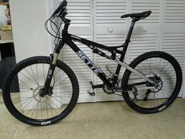

    Bought the Derro frame after my Giant Xtc Air cracked. It was an impulse buy after a couple days looking on ebay and not seeing anything I liked the price of.
    Here is the build sheet.
    Bottom Bracket:* raceface x-type
    Brake Levers:* shimano deore hydros
    Shifter R SRAM TRX 9 speed
    Cassette: Xtr 9 11-34
    Rotor F 160mm
    Rotor R 160mm
    Chain:* Sram 9 speed
    Crankset:* racefac evolve 32t/bashguard
    Derlr (Front) Jump Stop
    Derlr (Rear) shimano xt gs
    Shock fox float rp-2
    Fork: rockshox sid 120 rlt
    Grips: ergo
    Handlebar:* easton cf monkeylight
    Headset:* Cane Creek
    Pedals:* eggbeaters
    Seat:* wtb rocket v
    Seatpost:* sette carbon
    Stem:* truvativ stylo 70mm
    Tire (Front) KendaBlueGroove
    Tire (Rear): KendaKarma
    Tubes: home made latex/windex/slime
    Wheelset: easton xc one
    Total weight clean is 26lbs.
    I have had the bike since April 2012, and put a good 400 miles on it as of this post. I ride 2-3 times a week, raced once in an 8 hour event, and consider myself a casual/intermediate rider. I am also cheap. Everything on the bike other than the brakes and cranks was used/traded,etc.
    The large frame is adequate for my size at 5'11, and 168lbs in gear. Could the medium fit too? Dunno, but it's too late to trade out the frame and see. The frame was a bit long, but the 70mm stem helped enough, and sliding the seat forward a bit. Hands got a bit sore and numb until I went with the ergo grips. Trying lot's of seat and handlebar positions until I work it out. It is tolerable unless I am on the bike for more than 3-4 hours at a time now.
    4" of rear travel and the fox rp2 with propedal rides great at 110psi. The sid rlt 120 front pairs well, which I use 90% locked out with the floodgate wide open. This makes a stable "platform" that compresses well over roots, rocks, logs, and jumps up to about 3'-4'. I'll bypass anything larger than that (the bike would handle it, but I wouldn't). On longer downhill sections it's easily in reach to switch the suspension to open. On the climbs the "platform" does not noticeably bob.
    Handling of this bike I can only compare to a giant xtc, an older specialized fsr, and a specialized m5 ht. Of all the bikes it is by far the tight feeling sports car; it corners and accelerates well, feels solid, and is quiet. When I do ride other bikes and get back on the derro I always feel like building this bike was a good decision.
    Looks wise it's a fairly generic frame. Black and silver is pretty standard color scheme, but I could care less what it looks like. Already I have scratches, chips, and grime all over it, and that to me is what a happy bike looks like.
    Pricepoint ignored my service request, but I still buy stuff from them. The bike didn't ship with the seatpost clamp, and I sent them an email with my order info asking them to send it to me. I never received a response. Instead just used the one off my Giant. Again, I am cheap. They don't have to have great customer service as long as the price is right.
    Bottom line is I am happy with the bike as a whole. Would I buy it again? Maybe, depending on what ebay/craigslist/mtbr, etc had to offer. Do I recommend YOU buy it? Yes, just don't expect a lot of support from Pricepoint.
    Note: older picture does not show the wtb seat or the ergo grips.
