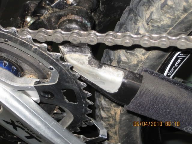

    Hey guys my anti-grind plate on the front swing-arm has faded and begun to chip off in huge chunks after a week of use. I thought this was metal but it appears to just be plastic. Anyone else have trouble with theirs.

    Pictures. It's turned a dull gray and is bubbling up.
    Give warranty a call?
    324
    Wow- that is some major eating away of that plate . I would agree with the last post to inquire to SC about it. Despite being plastic, it seems it should be a bit more resiliant
    than what is happening to yours.

    I talked to SC and that's the epoxy that bonds the metal plate to the frame. Apparently my plate has fallen off somewhere on the trail or during transport. No word on what they are going to do yet.

    Looks they are sending a new grind plate. Now how do I install the new one? Super Glue? lol
    328
    Use Epoxy or Polyurethane glue. I reglued my plate after it fell off with the latter and it is not budging for a year now.
    324
    I would expect for them to have provided some basic how-to instructions with the communication that they were sending you a new plate. It should'nt be assumed that
    customers know the repair process for this issue.
    Questions I would have for the person at SC you communicating with:
    -Any specific epoxy, i.e. that doesnt react adversely to the finish or carbon fiber?
    -How should the surface be prepared so this doesnt happen again? Should the old epoxy be removed? If so, how?
    Sorry if these questions seem are obvious but I would want to minimize any risk w/ messing up a $2000+ frame.

    Ok the new plate already has epoxy. I just peel off the sticker and slap it on the frame.

    Did that grind plate hold after the simple peel and slap on? Did you remove the old epoxy first?
    I lost mine too, and got a replacement. I was told that I'd have to use epoxy to glue it on, but the metal plate came with a peel off sticker too. Wondering if I should trust the peel and slap on.... Thx.
    440
    I removed all the epoxy I could without damaging the frame (The frame ended up breaking anyway because of a bad bolt in the linkage system). From my limited experience with the replacement it did not seem to hold very well with the epoxy already on the replacement grind plate. They may have changed things up though.

    The epoxy already on the frame looks like it creates the proper shape for the new plate to conform to. I wouldn't remove it- just get it clean. If you want to use a new thin layer of epoxy, give the old layer a little sanding.
