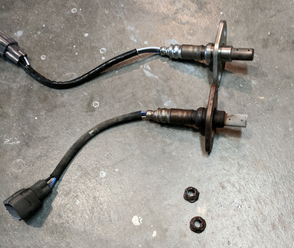

    OK, how about this; should a thermostat be replaced after 200K+, even if it still works? I'm willing to replace it even if it's not the problem.
    I've got pics of belts and error codes coming, stay tuned!

    Well, Iíve never known of a thermostat benging a maintenance replacement thing. Only when they go bad are they replaced. But youíve already got it and are willing to go through that, I guess go for it. It canít hurt to have a new thermostat. But be forewarned many new thermostats are bad right from the manufacturer. Boil some water and test it before you put it in. Otherwise you go through all that and button it back up only to find out the new one you put in is bad.
    Get a pan of water and put the thermostat in.
    Get a thermometer to measure at what degree it opens if it does at all.

    I watched a video on heating up a thermostat. It should open at 180 degrees. I don't have one yet, and now I'm thinking I should start with what I have, and that's an O2 sensor and an A/F sensor. These codes are telling me that's what it is.
    And for the belts; they were replaced in 2014 when I had the timing belt/water pump done. From what I've read, the belts shouldn't be able to be turned more than 90 degrees, or deflect 1/2", so maybe the AC belt is ok and the power steering and alternator belts need tension?
    AC belt
    Power steering belt
    Alternator belt (note the small tear in the side, probably ok?)

    Ask for a smoke test. Or, you can actually buy a can of smoke and check for yourself.
    My youngest sons E46 kept setting codes; first, "O2 bank one", then, "O2 bank two". I knew it had to be something common to both banks on a split exhaust system. The smoke test revealed a split down low on the intake boot behind the mass airflow sensor. The boot cost me $11 but took about 45 minutes to replace on that thing. Never set another code.

    Aren't an O2 sensor and an A/F sensor the same thing?
    I had to replace an O2 in my Forester.
    Kinda sorta. On the Denso part finder when you click on A/F sensor it automatically checks off the O2 sensor as well. They work as a pair measuring the amount of air before and after the cats.
    Yes and no. The primary O2 sensor is more for a/f, the secondary is just to monitor your cats.
    If your cat goes bad and you have a standard threaded type sensor just get a 18x1.5mm sparkplug anti fouler. Put that on the sensor and ta da no more P0420. Works on most cars. some sensors don't fit unless you drill out the anti fouler (Nissan). But I never said that. Check your local laws and regulations first.

    I think I fixed my truck! I've only driven about 5 miles, but the CEL hasn't come back on, we'll see what happens tomorrow.
    After pondering for some time, I decided there wasn't any good reason why I shouldn't change out the pre-cat A/F sensor, so I got after it! The first nut came off fairly easily, but I did notice the socket wasn't seated very well. Moved on to the second one, which is a bit harder to see, and couldn't get the socket to grab at all! Upon closer inspection I realized it was rounded over, damn, I'm screwed! A few minutes later I grabbed a small Vice-Grip (which I bought at an estate sale a week ago, it was a vintage gift set of a big and little one) and was able to get it to turn, YES!!! It only took another couple dozen 1/8th turns before I was able to get the nut off.
    I'm thinking one of the previous owners attempted to replace the sensor and just gave up after rounding the nut, not sure if a shop would have done that. The dealer I bought the truck from probably cleared the codes before they put it on the lot.
    I went over to Autozone and tried their threaded display and the nut didn't fit any of the threads perfectly, but it moves pretty easily on the stud. I think it best matched the M8 threads. Does anyone know where to find out what size threading it is? I was going to go down to the dealer and get a nut, but I'm thinking it should be a fairly standard size that I can get at the hardware store around the corner.

    most Tacoma O2 sensor nuts are 8mm x 1.25.
    Thanks Internet!
    Terms and conditions may apply
  44. #444
    Life's a Garden, dig it!
    Reputation: chuckha62's Avatar
    3,670
    Was just going to say... 8mm x 1.25 pitch.
    My ACE Hardware has a great selection of metric nuts and bolts. Those nuts look like lock nuts. Buy regular 8mm and use a split lock washer instead.

    I've been going to Menard's for hardware, not sure if there are any in CA. I'll get a couple stainless nuts and lock washers.
    There was a buildup of rust and junk under the gasket on the stripped nut side, so I think that nut had been loosened before it got rounded over, and then just left, perhaps that could have been an air leak in addition to a bad sensor.
    I wouldn't use stainless unless the bolt is stainless. Dis-similar metals creates a whole other issue due to galling. If you do use stainless make sure to use anti-seize.
    Just called Toyota and they'd have to order them, so I'll just stick some anti-seize on there with the stainless.

    Well I got rid of one code, P0171 came back.

    MAF (Mass Air Flow) Sensor. May not be a bad sensor, but a difference in what the MAF thinks is flowing versus what your new O2 sensor is seeing out the exhaust. Look for a leak behind the MAF. This is what happened to my Diesel Benz and was never found by the dealer. It caused the car to get labeled a "lemon" and I bought it CHEAP. Once I found the problem (a cracked plenum), it hasn't set another code.
    A smoke test should find it.

    clean your maf and check for torn boots or vacuum leaks. as far as a 10mm socket you might find some in irrigation boxes, parking lots and well pretty much anywhere.
    I try to keep up on cleaning the MAF, and I meant to do it before I left but ran out of time/forgot. I'll be looking into the smoke test and talking with my wrenching friends in SoCal, we should be able to get it code free without too much trouble, I'm already half way there!

    Now it says 120 something miles on the trip OD!*
    *What is missing in this picture?

    629
    a CEL?

    Quote Originally Posted by azimiut View Post
    a CEL?
    Correct!
    After changing out the A/F sensor cleared one of the codes I wanted to clean the MAF and see if that would fix the P0170, but I ran out of time before my trip. I finally cleaned it and the code has been gone! If it stays off that means I don't have to go hunting around for the problem (smoke test, etc).
