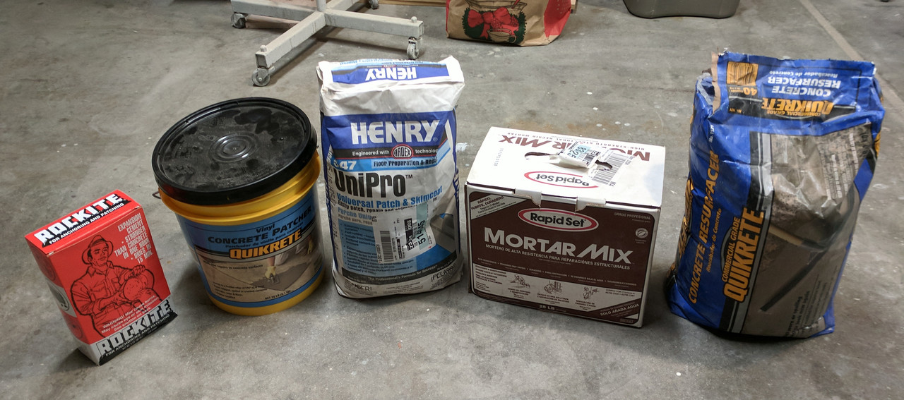

    Reputation: theMeat's Avatar
    4,981
    2 thinner coats instead of one thick and it will get hard faster. One big thick coat and it will take much longer.
    Red guard is not cheap
    Looking good
    Round and round we go

    Well, here's the coating I'll be removing, unless it has gotten hard by tomorrow. I think with the temps, me mixing it too thin, and the OSB and dry air sucking the moisture out of it, it didn't cure properly.
    This space intentionally left blank. We apologise for any inconvenience.
  26. #826
    4,981
    Doesnít sound like fun
  27. #827
    Pipe Dreamer
    5,348
    It's just the price you sometimes have to pay for pushing the limits...
    Or because you were in too much of a rush to do a test.

    If anyone knows how to get an even coating of 1/8" thick cementicious product on a surface please speak up!
    I have a 1/4"x3/16" V-notch, but after troweling it only leaves about 1/16th when compressed. Maybe I pulled it too tight and scraped away too much material.
  64. #864
    Self Appointed Judge&Jury
    Oct 2000
    35,489
    Quote Originally Posted by Cornfield View Post
    I think you answered your own question. Taking away too much material, maybe try a 1/4Ē x 1/8Ē for less depth and easier to compress with less pressure. Not sure if you can find a V notch in that size but I think that U notch comes in that size.
    Any way to clamp strips around the perimeter and use a screed board?
    I was looking for a bigger tooth V-notch, but I think the square would work. It would be just like putting down a layer of thinset.
    I've got bullnose that curves down to the 4" sides, so no. My friend suggested using a long straight board to lay on top and check progress.
    Quote Originally Posted by theMeat View Post
    Not familiar with this product or process but maybe apply with v trowel and let dry as is with groves intact. Then apply another coat with flat trowel over
    Good idea, but I think that'd be too much work, and would be hard to keep a straight line next to the bullnose. I think I'm going to try the V-notch and see how it goes, sorta like the first part of this vid:
    Since you have bullnose, is bullnose wood?
    It's where the top transitions to the side, I used a round over bit on the router, can't remember what size.

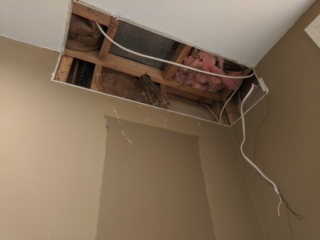

    Hmm...I wanted to update all of the wiring before replacing the ceiling throughout the house, but I was told today the city would allow me to take a test to be able to apply for permits, but would never allow me to replace all of the wiring throughout the house. They would sign off on permits to do things like add or move an outlet, or wire a small room. Is this normal? Do you just bite the bullet and pay someone to do it? Do you do one room at a time over 5 years?
    Sucks trying to improve anything.
    dang
    Would do it to code without permits if doable
    Why would you tell the city anything if you are capable of doing the work and/or have some professional guidance so that the work is safely performed and meets current codes?
    Hey they don't know my name or address. Didn't call from a house phone, just asked questions and said thank you and goodbye. I was just trying to be proper. Some of the shit I've seen in my walls (had a light switch blow because they left the ground wire loose and it somehow touched the hot wire, we fixed that) I'd really rather the previous owner had shelled out the dough. They had to have used a couple extra hundred feet of wire when they did it, too. The wires from one breaker traverse the house twice. Also not sure that I'd have used 14 gauge NM wire in metal conduit or in other cases left it totally exposed running along a brick wall from the floor to the outlet and back to the basement.
    FWIW the inspection process when buying a house is a joke here. Pretty sure the inspector was drunk.

    Alright, a couple quick electrical questions for y'all. By current NEC codes, pretty much all branch circuits need to have AFCI and at least a few need to have GFCI protection, too (though I can't see how having GFCI would on all of them would be a bad thing besides extra cost). So:
    If you use a dual-function GFCI/AFCI circuit breaker for the origin of the BC, you obviously don't need to make sure the first receptacle in line is AFCI (which is an alternate way to do it that is to code), but do you still need individual receptacles in kitchen or bathroom to be GFCI? For some reason that part was clear to me for AFCI but not GFCI. Also, a way I've seen to do it was to use AFCI circuit breaker and GFCI receptacle, but maybe that's equivalent (if not unnecessarily costly?).
    Also, I see a lot of reviews for dual function circuit breakers that say that they "trip too easily". Doesn't that really just mean there's a fundamental problem with the circuit? Too much load or a damaged sheath on a wire? I mean, if you're gonna spend $50 on a circuit breaker it should trip if there's a problem.
    Feeling much more confident about planning after reading codes, though. Also feeling much more surprised the inspectors didn't raise a stink at some of these things. I have unprotected NM cable (not in conduit) in pretty much every room, most of it is grounded (white), but some is actually ungrounded (black). I read current codes as outlets need to be 6" above the floor minimum, and they put many outlets right on the baseboard only 2" off the ground.
    dang

    Codes can be/are very local. Round me, in most places, afci is required on main brkrs and thatís it as far as afci in residential.
    Far as gfci, again, round me, gfci must be in, or within 6í of any wet location. Sink, tub, washing machine etc. gfci must also be on 12 gauge wire.
    You can run gfci outlet first in a series, then connect onto that gfci load side and the rest of the outlets after that outlet, in that series are gfci protected.
    Havenít heard afci/gfci brkrs always trip, but theyíre def more sensitive. Also donít see the need. Unless you are running dedicated runs to a pool or hot tub would use gfci outlets, which you can run in series as described.
    Sorry I couldnít be more informative, hope this helps. If I were in your shoes would try to network/find a friend of a friend who is licensed in your area to steer you in the right direction.
    And yeah, some inspectors are very overlooking, and some very thorough.

    Thanks, it helps a lot. The plan I had decided on was to use AFCI on all main breakers and GFCI at outlets as needed. Local code isn't as well written as the national code, here. Frankly, just about anything is closer to code than what's going on now, the more I look at it.
    Edit: FWIW, the city's website only lists NEC 2017 as the adopted electrical code, so as these things only seem to get more strict, I should be gold by using 2020.

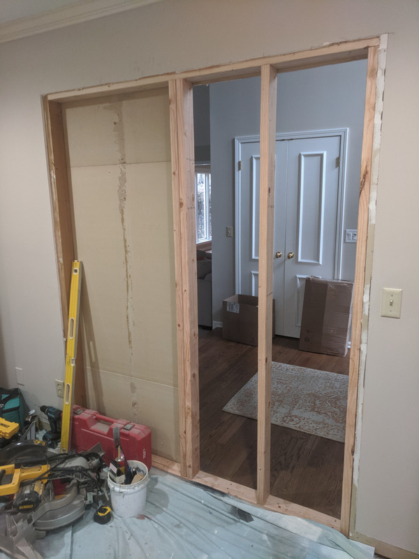

    Reputation: WHALENARD's Avatar
    Feb 2010
    5,148
    Ask where they want a tv, put a 2x6 or 2 on edge there and rock in the rest leaving the door alone if possible.
    We recently had a big box store drill through the wall and into the main bus of an 11 story high-rise to hang a TV. Wait untill that tenant gets the bill...holy shit!
    Sent from my moto g(6) forge using Tapatalk

    Pipe Dreamer
    5,348
    It's pretty basic, just a standard single sliding pocket door that goes into a 2x4 wall. I just need to open it up, remove the door and all it's interior framework (being careful not to pull the screws/nails thru the outer side of drywall), then frame it in and rock it.
    I think I'm being overly analytical about it. I'll just start tearing into it and fix it back up.

    Cycologist
    Reputation: chazpat's Avatar
    6,657
    My house has bi-parting pocket doors. I just looked at it and you could do like whalenard suggested and just rotate the studs ninety degrees on both sides. But probably better to take it out. Are you going to wire in a new outlet for the TV, or even run it up the wall to the mount?
    This post is a natural product. Variances in spelling & grammar should be appreciated as part of its character & beauty.

    Pipe Dreamer
    5,348
    Hadn't even thought about an outlet, good thinking! It's a door, so there's no power running along the wall down low, but there may be an outlet close to one side (like in the pic below) that I could tie into. I'll check it out tomorrow or Wednesday.
    This is probably similar to what it looks like behind the sheetrock. I suppose I could find out where the TV might be mounted and put some blocking on edge between the studs as Whalenut suggested.

    Pipe Dreamer
    5,348
    Next question: I have a can light in a soffit above a bathroom vanity and want to remove the soffit and put in a box for a wall mounted light. This should also be pretty straightforward, right?
    Feb 2010
    5,148
    Provided there's no plumbing in it for an upstairs bath and the existing wire reaches the new box height about as easy as it gets.

    Pipe Dreamer
    5,348
    It's about 3' wide, 1' deep, and 10" tall right above the vanity. I'm fairly certain there's no plumbing in there, it's just there to house the can light in this 70s-80s house. I'll pull the can and see how much wire is there before I start tearing into it.
    Feb 2010
    5,148
    Yeah, unlikely it houses any plumbing or venting but ya just never know. Even if the existing wire doesn't reach if you have the ceiling rock open to the wall the switch is on pulling new wire should be super easy. Also a good time to add recep's to the vanity area if they would like any.

    Pipe Dreamer
    5,348
    They were also talking about replacing the fans, but they're the old circular ones. Just found this video of the ones I think they have, might see if I can just clean and oil them instead of turning a round hole into a square for a new modern fan light.
    Feb 2010
    5,148
    If your cutting out rock now's the time to tackle the fan. Put in a nice quiet one with a light. Add one of those programmable light switches where you can easily program the fan to stay on for a given duration after use. They'll love you man. Once you open up the rock around the fan those things are really simple to replace. Bonus if it vents out an exterior wall right there but if not there are all manner of HVAC adapters to tie into the existing vent.

    Cycologist
    6,657
    Check that the fans are properly vented, sometimes they just dump them into the attic which can cause condensation problems.
    I have a bunch of can lights I would like to replace with LED canless lights but not sure how easy it would be to pull the cans. I'm not sure if they were original and probably tied into joists or of they were added and probably pretty easy to remove.

    Reputation: BlueCheesehead's Avatar
    1,561
    It sounds like you may have to extend the wire. One thing to remember is that per code wire splices need to be protected, like in an electrical box. Also, you cannot make an electrical box inaccessible, like burying it behind drywall. If you can get to the box in the attic, that is fine. The other solution is one of these: https://www.homedepot.com/p/Tyco-Ele...E&gclsrc=aw.ds

    Pipe Dreamer
    5,348
    The guy want's to spend some money, but he doesn't want to go all out, so right now I'm kinda feeling him out (no, not that way!). He did put a call in to an electrician about the fans, so he is willing to replace, but I bet he'd be all over new or oiled motors. He was questioning me wanting to remove the old pocket door instead of leaving it in the wall and patching in just the opening because he is not planning on hanging a TV. He's all about doing stuff for resale vs his taste, but I can't see leaving the door in there even if you would never be able to tell.
    Feb 2010
    5,148
    They make led lights you can screw into the existing can socket and push into the existing can. They have their own sconce built into the light such that you can't tell it was retrofitted. HD sells them.
    With that whether the the can is a remodel style or anchored to a joist I find them equally easy to pull. The low voltage one's with a central power source will be much more involved to replace with a new system
    Feb 2010
    5,148
    Quote Originally Posted by BlueCheesehead View Post
    I've not used or come across those romex splices before, I need to check one out. It's funny I see electricians burying splices all the time. Epecially for long runs like exterior lighting for apartments or commercial buildings. God forbid the layperson get caught doing it though.
    It is no measure of health to be well adjusted to a profoundly sick society.
    1,561
    Quote Originally Posted by WHALENARD View Post
    I used one on my bathroom renovation. They snap together and feel a bit hokey. I wrapped mine with electrical tape just to make sure the little tabs did not pop loose. It seems to me one would be better off burying a box as long as wires are properly nutted together.
    BTW, Tyco also makes one to tap a wire on to an existing run.
    Feb 2010
    5,148
    I believe I have seen those used before for branch taps but they were accessible. I think Ideal makes a similar product as well. Big fan of those push style wire ties Ideal makes. So much cleaner and easier to deal with than traditional wire nuts.

    Pipe Dreamer
    5,348
    So I pulled one of the fart fans and it's ~11.5" in diameter, then there's three more upstairs that are 12.25" across. Are there any round replacements out there that would fit in the round holes?
    And I was able to move the can light over and take a pic inside the soffit. There's a few wires running thru it but nothing else, and it looks like there's plenty of it. I believe the wire coming out of the can box is the one hat goes up and over to the fart fan, and maybe the one on the right returns to the switch. He's got the electrician scheduled for monday, so I think it's safe for me to demo the soffit at the very least.
    Feb 2010
    5,148
    Those fans aren't that old. You can pull the model# off that sticker and special order them through HD or possibly easier through a good appliance store. Word to the wise order the complete fan- motor/bracket/squirrel cage as a single unit Also I'd double make sure they don't work first by plugging them into an outlet or extension cord. Hate to go through all that trouble for a thermal fuse.
    *Oh wait I think I misunderstood your question. Doubtful you'll find a fan that won't require cutting out rock. Typically any new one is going to mount to 2 adjacent joists with straps.

    Yeah Korn, that was a question without a question mark. Care to explain all those products? Never mind, you deleted that post.
    What are you talking about? I'm not a moderator, I can't delete posts!

    You posted a photo of 6 or 7 different concrete products. Am I really losing it? Could be, Iím on my ďjankyĒ cell phone.

    Hello! Korn, where did you post photos of several different bags of concrete product? Possibly earlier in the thread? Seems it was right here on this page this morning.
    If you say you didnít itís obvious you deleted it.

    Bottom of first page , DJ

    Thanks Meat, that's it.
    Sorry Korn and NDD, posting off a ďjankyĒ cell phone during a dinner break. I seriously thought you deleted a post. I thought that photo looked familiar.

    Did some tear out and started framing in the door opening. Everything came out pretty easily, just gonna wait till the electrician comes on Monday and let him deal with the wiring. The wires in the right corner go to the switch in the laundry room, and there looks to be enough wire to make it to the new light location. Don't know what the one going under the duct is, it's a bit thicker than the romex.
    Need one more stud and will rock it up tomorrow.

    So removing the door paid off, especially in the long run. Peace of mind knowing it was done correctly.
    Speaking of which: I donít know how some contractors [handy man] sleep at night.
    Isn't that going to be an issue (though I guess for the electrician) in that the wire runs under the joists and in front of the studs? If you're going to sheetrock flush the wire will have to be rerun, right?
    It had to come out, there would have been no way to put a stud under the header with the track in the way. The "header", was two 2x4s on edge with a piece of ply sandwiched in between. Actually it could have been 2x6-10s up there, could only see the bottoms of the boards.
    I'm sure they'll figure it out, haha!
    Looks good
    Did you put sole plate on sub floor?

    Yes. There was a piece kinda like a breadboard end in the threshold, I just removed that and put the sole down onto sub with a 1/8" gap between it and the hardwood floor.

    Since the electricians were on the job anyway, I let them move the wires. My AV friend was there and said I could just notch out the studs and put those metal plates over where the wires were, and that's exactly what they did. I didn't think it would come out as good as it did since those plates were sticking out like 3/16" on the studs. Like it was never there.

    Looks good!
    Yeah that metal plates are a need in this day of pex tubing, csst pipe, and romex cable.

    Got my wiring done today. Got everything ran without having to cut any new holes. The small round hole was where the old porch light was. So that will get plugged and patched.
    Speakers and amp will be installed tomorrow. Then I gotta decide what wood Iím going to use for the ceiling.
