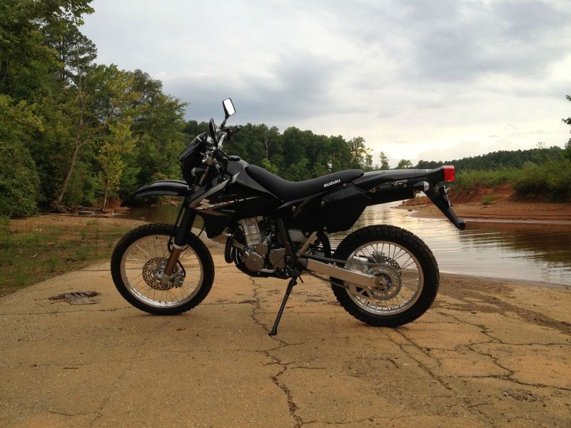

    Thanks for everybody who had input on this thread. I ended up with the DRZ and just took it on her Maiden Voyage. This bike is a blast to ride in stock form, I can only imagine once I let her breathe!! Anyway, here is a picture! *edit* I almost forgot to mention, these stock tires BLOW in any kind of slick stuff. Any reccomendations for a good 60/40 or 80/20 tire? Thanks!
    650
    Quote Originally Posted by StopTheExcuses View Post
    Congrats!
    Put a knobby on the front: I think all the Pirelli front are DOT, with the MT16 or XCMH being the best for dual sports. The Dunlop D606 and Pirelli MT-21 are a little better on road, and worse on the trail. If you ride somewhere dry like California, you don't need the extra grip offroad.
    For the rear, the Kenda K270 is a decent dual sport tire. No as good as a knobby offroad, but it will last way longer. The MT-43 is nice, but has a tall sidewall and will make the seat height higher, which you are trying to avoid. All the true knobby tires will wear out in 800-1000 miles, max, so unless you are riding mostly trail, I'd try the K270 first, or the Shinko knock-off of the K270.
