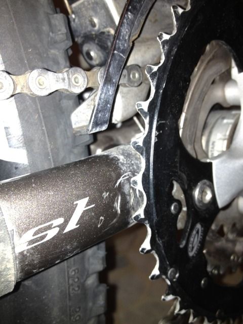

    Let me know what you think, I'm on a Shimano BB using both spacers (one at each side)

    With a shimano 68mm bb you use 2 spacers on the drive side and 1 on the non drive side.
    81
    That's too close for comfort.
    The 2011 EMD 9 has a 73mm BB so one spacer on the drive side and none on the other is the correct way.
    Taking out the spacer from the non-drive side should give you 2.5mm more clearance between the chainring and right side chainstay.

    Apparently I got one missing then, where's a good place to find one?

    Quote Originally Posted by tracke30m3 View Post
    Got it, will remove it then until it's too late.
    Thnx
