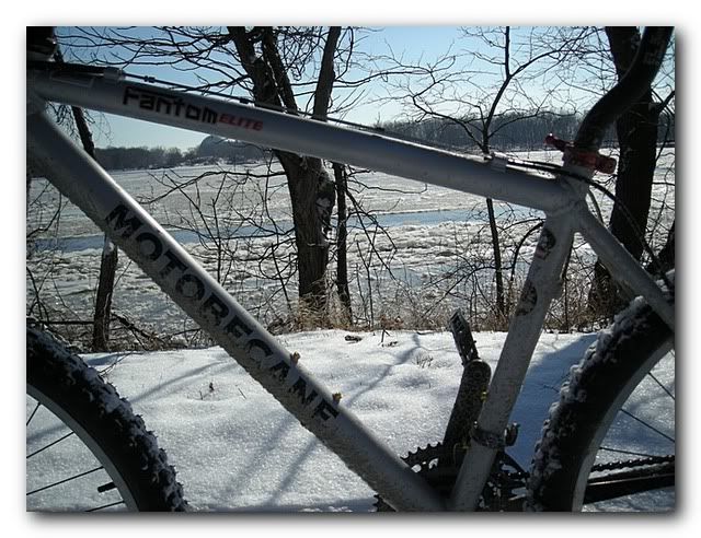

    I had a Fantom elite and it came with those cranks and BB. I ridden that bike for years in the snow, rain and sand. I never had to do anything to them. At one point in time I thought I developed a problem as it seemed hesitant and made some grinding noises. However, it turned out that I needed a new chain.
    After, that it was all good.
    Good Luck!
