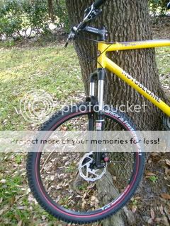

    I was skeptical about the size first and didn't think it was 140mm, but I measured it and there is 155mm of exposed stanchion, and when I held the Vanilla R up to it, side-by-side, they had the same amount of travel. Was a 140mm Dart 3 available last year?
    Heres a pic of my bike and the Vanilla for reference on size. They aren't next to each other, but compare the length of the lower legs to the length of the stanchions, and its about the same on both forks.
    The more I look at the frame and then look up frames made for 140mm forks, the more I question it. Like you said, it must be made for a 100mm fork, and I'm not sure why they would put something so big on it. I e-mailed them, so hopefully they'll get back to me with an answer. Since I've got this fork though, I guess I'll just have to build another bike

    Stanchion length does not tell you how much travel you have. With most forks, even when fully compressed there is still some of the stanchion showing. But the really important measurement in this case is axle-to-crown. That is measured from the center of the axle to the crown of the fork (the surface that the lower headset race sits on). I would imagine that the Fox has a much larger axle-to-crown then the Dart. For some reason I can't see your pics, so I can't really tell.

    Huh. I'll have to measure that axle-to-crown distance that ljsmith mentions just to get an idea about what size the fork could be and how it compares. As far as my thinking it being 140mm, I assumed since the stanchion length was 155, there was still about 15mm or stanchion left even if the fork bottomed out, leading me to believe it was 140mm. I will definitely not be using that Vanilla on this frame though. I'm in the same scenario as the guy in the link you posted above...worked fine so far, but who knows how long until it snaps.
    Here's the response I got back from bikesdirect about the issue:
    "Most likely the fork will work, however if the frame were to break after installing the aftermarket part, the frame would no longer be covered under warranty. The Fantom frame with the longest traveling fork is the Fantom Pro with 130 mm of travel. Hope this helps."
    I don't want to push it.
    Since I've got that extra fork though I think an Orange Crush frame would fit the bill and I'll just have to build another bike
    As for the fantom trail, I'll have to order a new fork so I dont end up broken myself. And the Dart 3 leaks oil everywhere. This bike has been awesome and I've loved riding it, its just my first real bike and I didn't know too much about proper fork sizing. Thanks for the help everyone, I really appreciate it!
