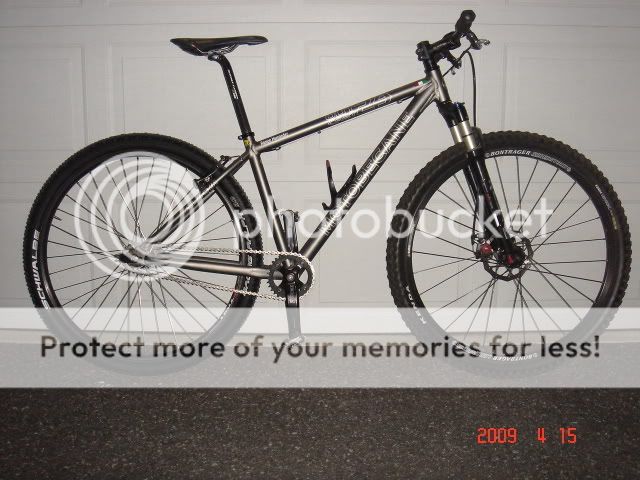

    Here is mine..

    Islance,,,I tested the bike and works excellent...I'm happy with the REBA and the frame Geometry....
    My frame is 17"..I'm 5'10"
    I'm happy with V-brakes (rear) and Disc brakes Front..The reason is that i can switch the rear tire and select a different ratio. I have on the bike 18T and 20T freewheels...If the trail is hard i just switch the wheels to 20T and adjust the brakes...I have 2 options installed..My friend with fancy single speed bikes (Disc) get jealous because thay can't have 2 freewheel options like me..
    Upgrades:
    Handlebar Easton EA70 --- $ 49.99
    Stem --Easton EA30 -- $ 21.00
    Fork --- Rock Shox REBA SL -- $ 350.00
    Front Wheel Bonstranger --- Free
    Front Brakes -- Avid BB7 -- $ 55.00
    Saddle Selle San Marco Blaze K ---- $ 49.99
    Seatpost Ritchey WCS Carbon --- $ 49.99
    Weight -- 26 Pounds
    I don't remember the original weight...
    I'm going to remove the Kenda Nevegal because are too heavy...I'm looking to replace the tires with the Schwalbe Racing Ralph or Kenda Small Block 8 and save 1.5 or 2 Pounds.
    Baja

    Yes,,,Like me.... ....I have stock the frame,rear wheel and tire,crankset and rear brake...
    I just shave 1 pound to the bike installing a 29x2.25 Schwalbe Racing Ralph tire...I can't believe..The nevegals weights 940 grams and the new Racing Ralph weights 520 grams...
    Baja
