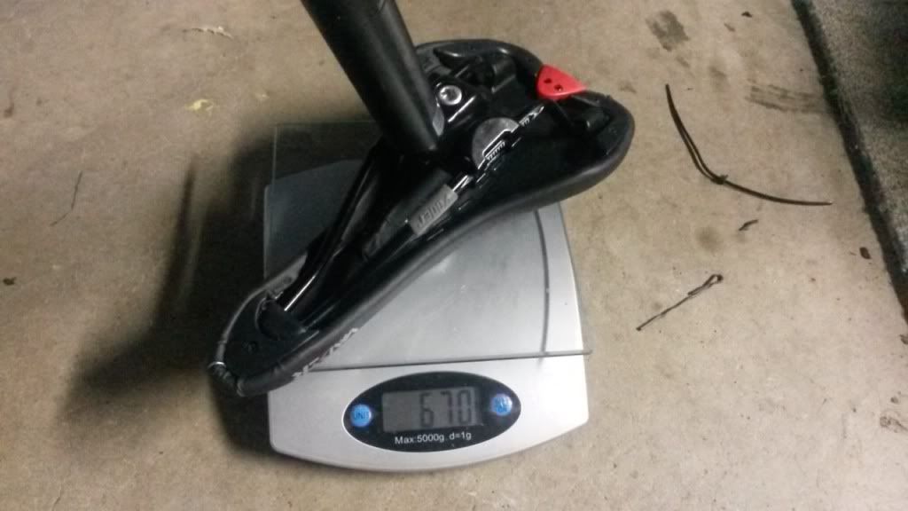

    Decided to get a weight on the stock steel seat post and saddle..Yikes
    851 Grams
    The SkyComp alloy post and Vader seat at 670 grams
    So far a weight loss in total of 354 grams. (0.78) or just over 3/4 of a pound.
    So this should now put the bike at 36.23 lbs ...its a start...lol
