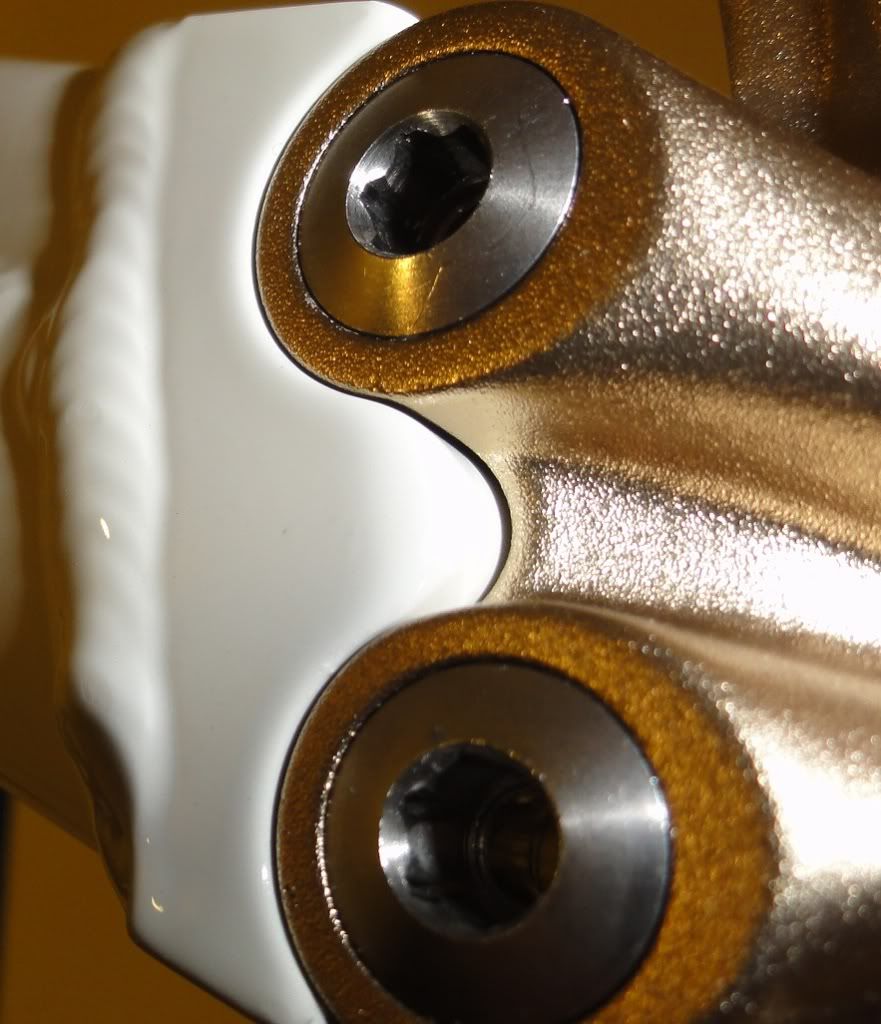

    Hey fellas, having issues with these replaceable drop outs.
    It says max torque for those drop-out & derailleur hanger is 25nm. That's surprisingly high considering crankset bolts are only around 12-14nm. See pic:
    Here's the thing, I set my torque wrench as high as it will go which is 24nm but before I can even get close, I can already tell the allen is starting to spin within the bolt head rounding it (I stopped of course, before I did and really bad damage). WTF? so maybe it's a Torx bit instead of an allen (5mm), so I use the best fitting torx bit (t30) - same thing, it starts spining within the head before I can even get close which only adds even more damage.
    So guys, how were you guys able to torque those bolts down so hard? At this point, I have to resort to just tightening the best i can with some blue loctite, but i know it isn't anywhere close to 25nm.
    Maybe my bolts were already a bit damaged since it was an OEM take off and I just need to get some new bolts. Considering it's such a special shaped bolt and receiver, I know I won't be able to just walk down to a hardware store for a replacement... have any of you found replacement bolts for your frame? Did you have to contact Marin directly or is there a 3rd party from which I can get these bolts?
    thanks in advanced.

    You should be able to see if the bolt has some damage right? I had my dropout out and put 'm back on with no problems. Just using te right # allen key.

    Quote Originally Posted by Betzel View Post
    Well that's what I'm thinking, the bolts sort of looked like torx bit when I first looked at them but maybe that's because they were already slightly damaged beforehand which gave them that look (if you know what I mean). let me see if i can pull off a macro picture.
    edit - here they are:
    slightly different angle.
    So what do you think? Does it look like these heads have been worked too hard to reach 25nm?

    derailuer side definitely looks worse.

    From the looks of it I would say they are quite severe damaged.... If this is torx than it is a very bad torx also. The lines in the bolts are not even so that should rule out torx....... It is strange though that all bolts are like this.....
    Very odd......
    Do you still have warranty? Otherwise a few new bolts won't break the bank i guess.

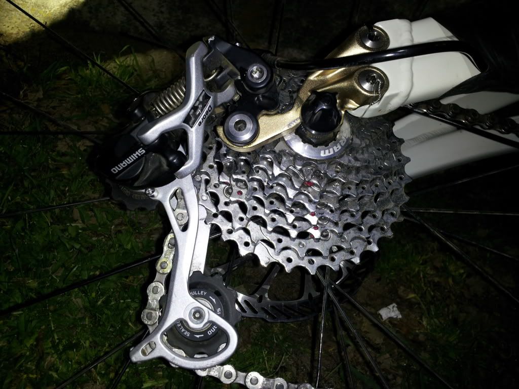

    So it looks like my Marin is down. I just came back from a night ride and this happened:
    Not Marin's fault - I was climbing a hill on my crankset's big ring, and while climbing I was dropping to the front middle ring while increasing to a bigger cog in the rear. Well because I'm using a medium cage RD, I don't have enough chain length to be on big-front/big-rear cog combination. This is why I was shifting down to the middle cog at the same time! Well the chain tension didn't allow the FD to drop it in time and my pedaling came to a sudden stop and that is the result.
    Sigh, I guess it's a hard lesson learned: if you're going to run a medium cage, it's better to side with an overly loose chain than a chain too short.
    Nother pic, this time with the RD off. It's bent backwards and inwards towards the cogs!
    I was able to bash it back away from the rear cogs but not back down (It was surprisingly hard to bask it back btw), but it did allow me to remount the RD and limp the bike home.
    So now the question is...
    Should I buy the maxle kit?
    If I do, I'd have to get a new rear wheel that excepts a rear thru-axle so then it leads to my 2nd question, should I get a 650b rear wheel or stick with a 26' wheel? Right now it it only has a 650b in the front.
    And a 3rd question is, do you think my rear derailleur is messed up as well? Visually I can't tell.
    Sigh... This is going to be costly. Guess all this Marin downtime will give me time to concentrate on the Jamis sixfifty b2 bike build up so i can get back to riding again.

    Wow...that looks very nasty! You were lucky you didn't hurt yourself!
    If you want a Maxle kit than you have to see if the hub is compatable. I have just ordered black(colored) dropouts (142x12) from the Marin AT (and a Shimano XTR thru axle). So if you check compatability you could choose between the complete Maxle kit (135x12) or X12 (142x12).
    p.s.....mine new (only mounted) Maxle kit could be up for sale soon, but i guess if you buy it in the States it will be cheaper anyway (postage costs).....

    I've bent them before when I've picked up stray branches in the chain. If you've got a blow torch [ I use a little Mapp gas torch]give it some heat while in a vice and tap it back with a hammer. Otherwise derailleur.com sells them.
    Wouldn't worry about the maxle kit unless you really think you will do it often.
    There's two different versions?
    I thought the only one available is this one here:
    Marin Bikes - Quad XC and Quad Trail SRAM Thru-Axle Maxle Kit
    So you're saying there's a wider 142x12 version? How does that work?
    Quote Originally Posted by gvs_nz View Post
    I'd be scared of the strength of the part of I bent it back. That and I wouldn't trust myself to bend it back true and straight. I'll check out derailleur.com though! Thanks!

    The 142x12 dropouts are not available in a kit. I have just phoned the German Marin import and asked for them. I'm paying about $50 incl. shipping for Germany to the Netherlands for these dropouts. You also need a different axle, in some of the pics of the link (previous post) you see the Shimano XTR axle i ordered also.
    So these dropouts come from the 2011 Attack Trail if i'm not mistaken.
    And if you change you will need a new wheelset. I think the Shimano wheels you have are not convertable to other axle-standards.......
    Interesting. So what benefit does at 142mm vs 135mm length provide considering the width of the axle is the same. Oh are you saying these wheels are actually wider? Sorry I'm kinda new to mountain biking still. Also wouldn't that screw with the chainline pretty bad or is the cassette placement corrected on those wider wheels?
    "Single track is for pansies!
    I blast down a mountain once, and in my wake, lies a new single track for the rest of you."-sm
    292
    It doesn't matter actually if you take 135 or 142.... 142 is the most common standard nowadays.
    A standard axle is 135x9 or 10 for a normal QR and 12 for tru axle options. It depends on the wheels which axle you can run. Some wheels are good for all the options (by changing adapters). Mine for example (Fulcrum Red Zone) works with 135x12 and 142x12. I just have to use other adapters on the hub.
    I just took a look at the Shimano website to confirm that you would need another rear wheel if you want to run a 12mm axle.
    292
    And p.s.:
    i also have found out of the 142x12 dropouts last week...... I was not aware of this option. The only advantage of the 142x12 dropouts is that there is a sort of edge in the dropout which will hold the wheel. The Maxle kit doesn't have that and you will have to hold on to the wheel and put the axle through. I only did this once on my bike now and the Maxle kit is not very userfriendly. So that explains my choice to buy other dropouts again. If the 142x12 dropout didn't have the edge i would have sticked with the Maxle kit. (well...and color is also a reason for buying the new dropouts....)
    edit: to your questions:
    the hub will stay in the same position. Only the axle becomes wider.
    And p.s.:
    I see - really appreciate the explanation! Sounds like the kit is cheaper too! Well maybe not... I'd have to buy the axle and an extra set of bolts separately. Oh and would definitely have to buy a new wheel. I was going to go ahead and get another Stan's built wheel to match the 650b stan's wheel in front so I'll have to see if they even make a 142 compatible rear wheelset. If they don't, I'll probably just stick with the 135mm and deal with the inconvenience.

    Quote Originally Posted by KVW View Post
    damn, not very cheap at 54 bucks, are they... assuming this is the right one: Derailleur Hanger #263
    Maxle kit is only a little more and you probably get a fresh set of bolts which I'll need... Hmm...
    Ouch. They used to be 1/2 that price.
    82
    sorry im a bit confused about the dialect of this forum. are you guys saying with the purchase of this kit i could convert my 135mmx12 marin wolf ridge to 142mm? btw i bought a spare set of wolf ridge dropouts with a through axle off PB for like 20 bucks shipped. keep your eyes out.
    292
    It is very simple:
    Maxle kit = 135x12
    Dropouts from the Attack Trail = 142x12.
    As far as i know you cannot buy the Attack Trail dropouts as a kit. So it depends on the willingnes of your dealer and you have to buy a axle to fit this kit.
    Dec 2009
    3,493
    It's good to know there is another option. I know the 12mm bolt through drop outs for my Meta are lots cheaper than the Maxle 12mm option. Don't know if that's the case for Marin?
    292
    Here are the 142x12 dropouts. Received them yesterday. Where the Maxle-kit has a straight inner side you see the difference with these 142x12 dropouts. So where you have to keep the rearwheel in position to put the axle in with the Maxle-kit you can rest the axle of the 142 rearwheel in the dropouts.
    As you see i have received a set of bolts to go with the dropouts. From the looks of the dropouts there are not new.....so i'm not sure if every Marin dealer could deliver..... And as i said before you have to get an axle yourself. the 142x12 is not a kit like the Maxle-kit. So i ordered a Shimano axle (SM-AX 75). The nut of this axle is to be fixed in the dropout with the small silver bolt you see in the picture.
    Edit: price dropouts together with Shimano axle is about the same as the complete Maxle-kit. And the torque on these dropouts is 25Nm....
    6
    Betzel, I'm trying to get hold of a set of these droputs for my Mount Vision. I currently have the 135mm Maxle dropouts (red).
    Do these have a threaded non-drive side dropout, thereby enabling the use of a standard Rockshox 142mm Maxle Axle?
    Also I'm in the UK, any pointers where to look appreciated. I've tried Marin's UK distributor before (when I was after the very hard to get hold of 135 Maxle Kit) and they weren't interested in helping me.
    292
    No, these dropouts are not threaded so you need a thru axle like the Shimano or with a nut at least.
    Marin doesn't deliver these dropouts as a kit so i guess you have to get the Marin dealer / distributor moving to get you a set. I was helped by the German Marin distributor. Like I said, mine doesn't look new so not sure where the Marin guys got them from....and if they have stock.... You have to drop them a mail....
    6
    Thanks for the info. I would have to replace the axle anyway so no great shakes, plus the Shimano one is half the price of the Maxle!
    Now for the hunt to find some dropouts. I do love my current setup but changing the wheel is a royal pain in the butt, hence wanting to upgrade to the Syntace X12 system.
