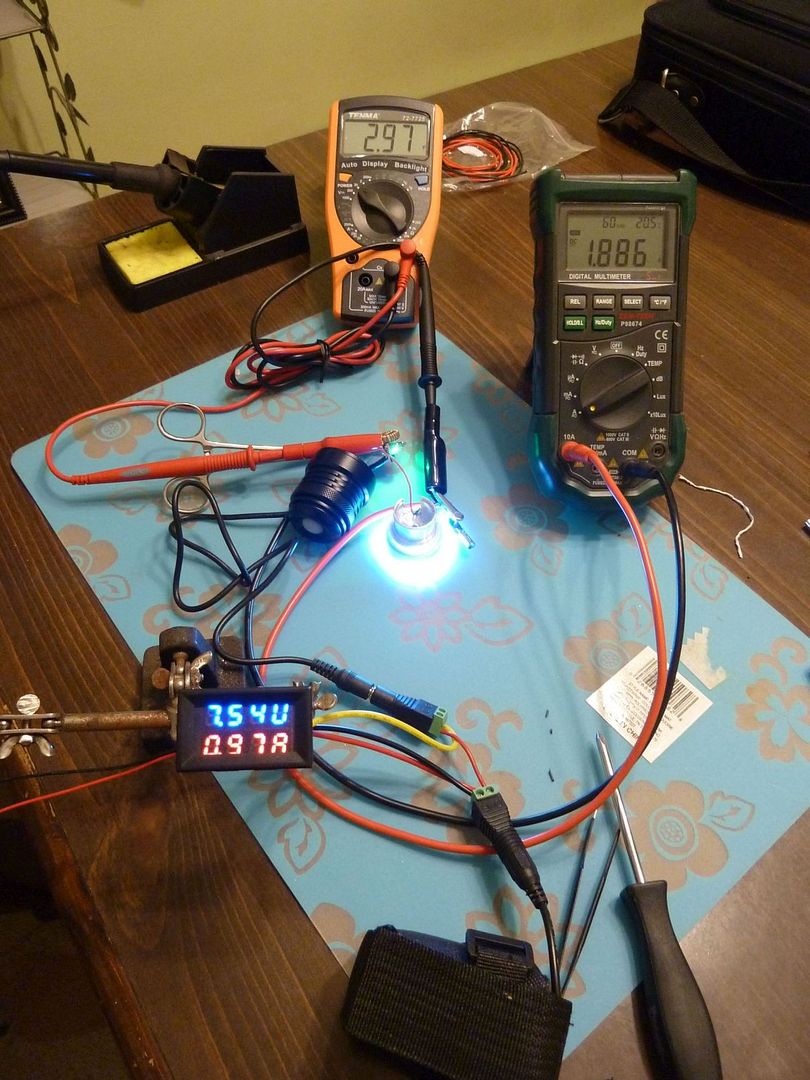

    Quote Originally Posted by TiGeo View Post
    ^^^So how to you test the batteries?
    To measure voltage under load, see the first post in this thread. There it is wired up to measure current but to measure your voltage under load you just put your volt meter on the "+" and "-" screws on either one of those connectors. OR, just go down to post #12 in that thread to the last pic and see the easy way to do it. You get current & voltage readings realtime. You can see I used it here in my GearBest Triple XM-L2 review thread (pic posted here from that thread):
    In that pic above, the battery with a 0.97A load applied has a voltage of 7.54v.
